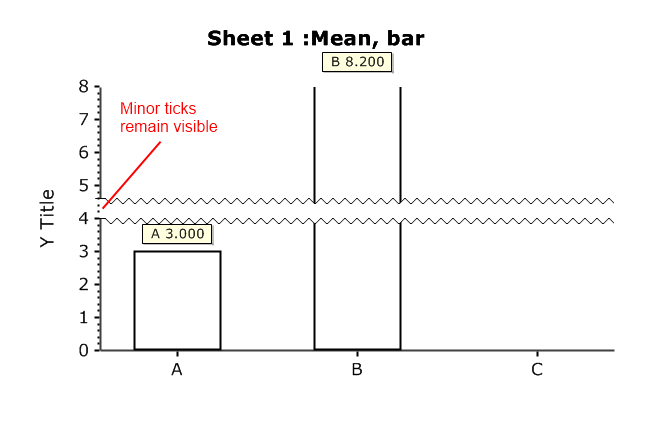

Secondly, minor ticks are drawn between the gap of the breaks. Just a minor thing, but is it possible to fix it in the next release?
I don't think this has ever worked. I added your request to the wish-list (TF02016324) to be considered for inclusion in future releases. If you remember this working in the past it would be very helpful if you could post the version number where this worked.

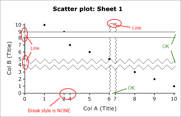

However, during testing I found a few other issues in the appearance of the breaks. It is just minor and an "extreme" case with multiple breaks (unlikely that a user makes a chart like this), but may be it can be resolved in a future release.

I've reproduced the behaviour with the code below so I've added this to the wish list too (TF02016339).

I've seen that hiding the axes pen makes some of the undesired lines to disappear, but if you want the axes to be drawn, then you'll have to draw them manually...
