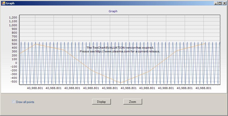

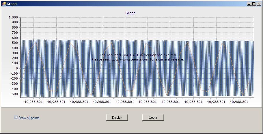

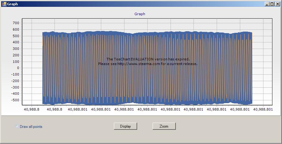

Post by asupriya » Mon Jun 11, 2012 11:53 am
Marc, I am using evaluation 4.1.2012.02284 as it was lat installed while trying Fastline.DrawAllPointsStyle option. Do you advice retrying with latest eval version?
I am getting the screenshots as shown below. Display of both original and smoothed series.
After some zoom
Further zoom
