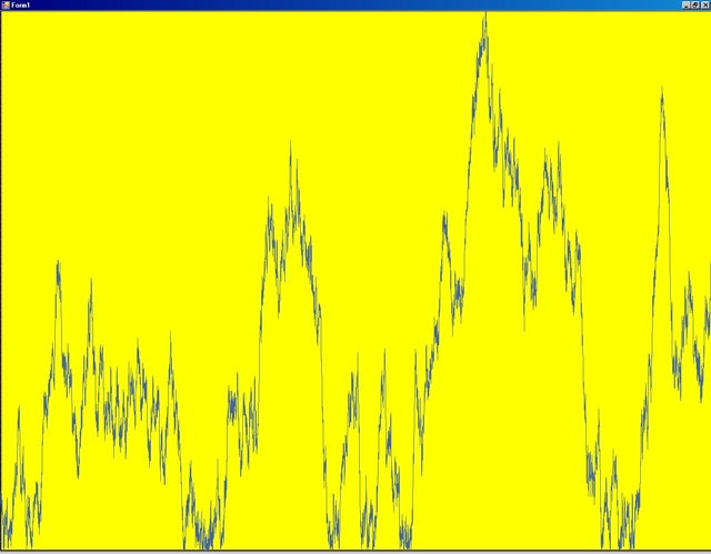

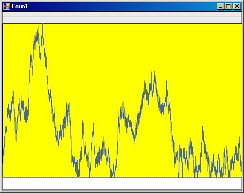

I think that I haven't understood well your problem. Please see next images I made using your code:
Image1: using SetMinMax() property and FillSampleValues=1000:
Image2: using SetMinMax() property, FillSampleValues=1000, and MaximumOffset = 25; MinimumOffset = 25:
Could you please tell us, if in previous images appear your problem with ColorBandTool?

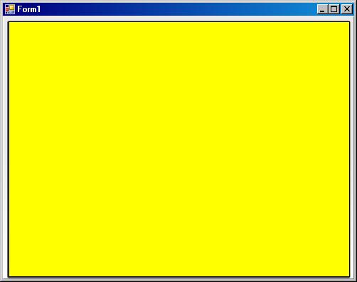

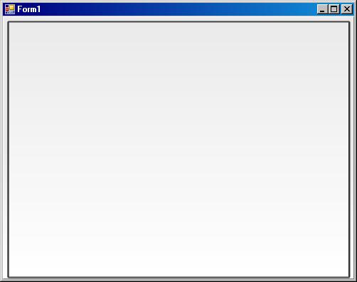

Ok, I have checked that your request and I have next gotten images:
Image1: Using 1000 NaN and SetMinMax()
Image2: Using 1000 NaN and tChar1.Draw()
It is obviously that in the image1 SetMinMax() doesn't return correctly MaxYvalue, so MinYValue=0, this is correct, but MaxYValue =1E-50, this is incorrect when should be 0, as in image2 using tChart1.Draw(). Could you confirm us if it is your problem when you are using SetMInMax() axes property?
