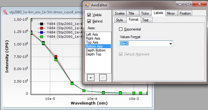

I showed the axis labeling with "00e-0" three colleagues: they assumed "10e-6"as 1e-6 (they assumed it to be comparable to 10^-6).
Me just encontered:

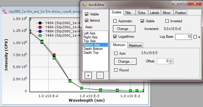

In the next image (test4a.jpg) the label format is '#.0 "x10" E+0' (another preset offered by the chart editor). Here the Steema chart editor and the TChart interpretes it as
"10e-2" = 1e-2. (this is the correct value for the label near axis.bottom.maximum)
So I did, and my colleagues did, too.
And now I changed the formate string to "00e-0" (test4b.jpg):
It seems to be very clear: such ambiguity must be avoided.
So I really think labelling has to be enhanced. It's not consistent. Such behavior must lead to confused end users. End users sometimes tend to look not as sharp as required.

As I can see you are a programmer yourself, there's no need for me to beat around the
bush.
No, I'm chemist. And as scientist I rely on precision, reproducibility and targetted functionality. My application under work shall fulfill these requirements. Main tasks / requirements are:
(1) reading experimental data from different sources
(2) import of my old file format
(3) processing data according to our requirements including enhanced data treatment like modeling or approximation
(4) ergonomic handling and unambiguity of presentation, good performance
(5) usability even for the potentially most stupid user
(6) publication-ready presentation of data
(7) trustworthiness (in accordance with the accepted principles of protection of good scientific practice)
My application will be used by, for instance, technicians, diploma and Ph.D. students. Their experience and ability to recognize a "wrong output" of experiments or data treatment by software differs. These circumstances I have to take into account before releasing the software. If instruments or software produce a wrong or ambiguous output users are sometimes not able to recognize that. And there are examples that such results occur in the literature, even in highly respected journals.
Now I will go to the concrete problem.
As you well know, a bug can be defined as code which does not function as designed. This is not the case with this issue. The code functions exactly as designed. So here we are discussing the validity of the design of the code and not the code itself.
I don't agree with you: From my point of view, correct auto scaling has to include the following:
(1) setting axis minimum, maximum and interval in accordance with the data to present
(2) unambiguous label formatting (preferably, it could be presentation ready)
(3) only points with values in the min/max range have to be displayed
The TeeChart code does not fulfill these requirements with respect to logarithmic axes. It's not imported for me whether it is by design or not. It is a bug in my eyes. If you say that is "by design" then - that is my view concerning trustworthy software - you have it to declare and to protect the user towards the possibility of presenting wrong data. And in your description and documentation of TeeChart I nothing read about this.
If I would implement it in the chart_beforedraw event I'm sure that it reduces the performance much more in comparison to the implementation in TeeChart code. Additionally, you have to take into account the end user. I mean the people working with the released application and the axis editor in order to process real world data: If I would implement something in the chart_beforedraw event the end user must be highly confused when he tries to format the axis chart editor and he does not get what he can expect (see point 5 of the above enumeration). This has to be seen in connection with the very wrong implementation of label format strings. One cannot demand that the user is familiar with the MS specifications of format strings. And here, I have no possibility to change anything without completely to exclude the axis editor from the project. So I can also not understand that STEEMA the things with the label format assumes as a topic of low priority. Nothing has been changed in the August release.
A further critical remark: [TF02014988] is declared as fixed for the new release. Has anyone at STEEMA done a deeper look on logarithmic (not only horizontal) axes with for instance negative exponents using the format string included in chart editor (and, I believe, suggested in tutorial or sample application)? Have you recognized that the midpoint of the labels is not under the tick? Have you tried to change "1.0*10^5" to "1*10^5" or to the more appropriate "10^5"? Possibly I will address this in another thread.
That's cool. I'm a medical doctor. Just goes to show we can be more than one thing at the same time :D
I think you forget:
(4) only data which is mathematically real should be handled automatically. Log(0) is not a mathematical reality.
TeeChart does not throw anything anywhere near an unhandled exception when non-real data (Log(0)) is added to the chart. What is more, getting TeeChart to handle non-mathematically real data in this instance is *one line of runtime code*.
Yes, one can. TeeChart for .NET runs in the Microsoft .NET Framework and so it is perfectly natural to expect people working in it to be familiar with MS specifications.
This is what [TF02014988] looks like in our database:
"There are a problem with axis scaling when you use exponent property scale of bottom axis, its position of labels is wrong."
To this extent this defect is fixed. If you feel that there are other defects associated with exponential axis labels, please do not hesitate to start another thread and we'll look at them.
All of the alternatives have advantages and disadvantages. The most important factor for my decision should be the expected required time and effort to come to a properly working application which meets the requirements discussed above. In the moment I'm still looking for the best answer.
It far from my responsibility to tell you how you should be developing your application. Obviously we would be very happy if you were to choose a TeeChart solution. TeeChart has been used in the real world for over 13 years. Have a look at the wikipedia article here http://en.wikipedia.org/wiki/Teechart.
TeeChart, like any piece of software, is not perfect. It has defects that we know about that have yet to be fixed and for sure it has defects that we don't know about yet. Buying a TeeChart control means buying a service which includes the fixing of defects as well as the modification of aspects of TeeChart's design paradigm to fit in with our client's needs. We are capable and willing to work with our clients to the best of our ability until our clients are happy with their purchase. Having tens of thousands of client does mean, however, that we cannot attend to any individual client's needs instantaneously.
I'm quite sure that we will be able to make you happy with your purchase of TeeChart. What I can't guarantee is when that will be. Please do start new threads for any new defects you have found and we will look at them and try to fix them in due course.
As far as the present issue is concerned, the handling of Log(0) values in a logarithmic chart, I'm quite happy with the way TeeChart works at the moment. As I have said, this doesn't mean that I have no intention of revising my position in the future as client needs arise. However, please be aware that today is my last day of work before my summer holidays. You'll have to forgive me if I don't give the issue any thought whatsoever in the next couple of weeks or so :)
Thank you!

I think you forget:
That's not true: There is no data value with log(0) in the chart! So TeeChart has to handle all data points!!! Possibly you did not understand the problem?
No. You can demand it from the programmer using your chart control, but you can't demand it from the end user working with the final application. He often will possibly never have heard anything about .NET. And when this end user works with Teechart editor no programmer can prevent him to do crazy things - only TeeChart code and his editor can do this. Possibly you have not really tried to understand my explanations?
And even this issue is not really fixed. It should work with any valid format string, and it does not. It even works not correctly with this string included in the corresponding chart editor combobox. I think one can expect that after programming or fixing any object the programmer checks the full functionality of that object carefully. Here it was not done.
Regards
What problem?
TeeChart handles the addition of non-real values (a data value of zero in a log chart) without throwing an exception. There is no problem here. However, as things stand, when the programmer adds in a zero value to a log chart, which he/she should know cannot be plotted, then we ask him/her to add in one extra line of code under some (not all) circumstances.
I honestly can't see how accusing me of not understanding what you write is in any way helpful to this discussion.
The TeeChart Editor is designed to handle stopping the end user doing "crazy" things. What it isn't designed to do is to accept whatever the end user adds to it as valid input. At the moment, the TeeChart Editor handles the format strings that it does. If you would like it to handle some more, please give me an exhaustive list of the ones that you want it to handle.
It is obvious that what you and I consider as a valid format string are two different things. As I said above, if you'd like TeeChart to accept format strings other than the ones that TeeChart presently accepts, please post an exhaustive list here (or give us a URL to one).
Thank you!
