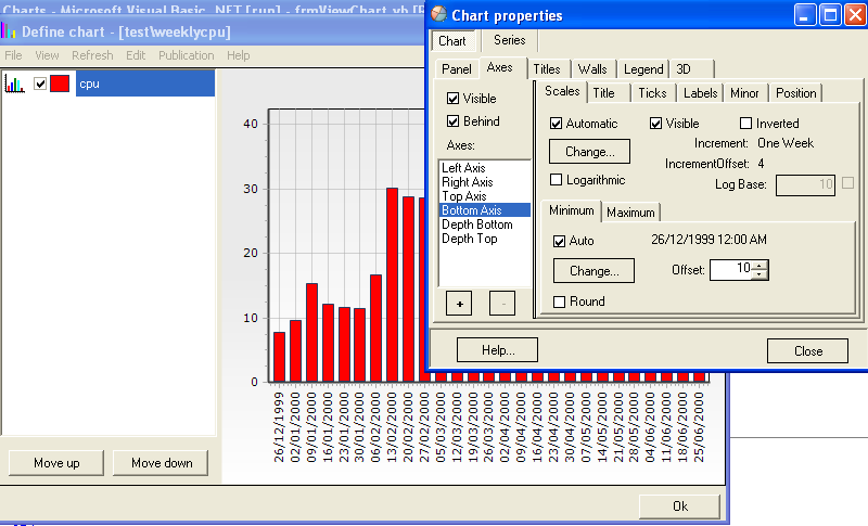

Post by Captell » Wed Aug 04, 2010 10:56 pm
Hi Christopher,

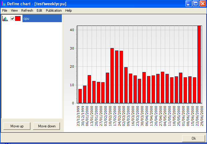

I've downloaded and installed the new build but unfortunately it doesn't really do any thing to resolve this issue.
My original chart with weekly increment set and data starting on 26Dec shows labels not aligned to bars
axis 1.png (17.75 KiB) Viewed 154479 times

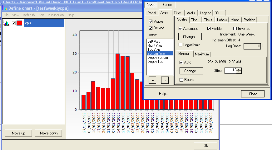

If I change the new offset value to 4 the labels are aligned.
axis 2.png (27.79 KiB) Viewed 154474 times
However If I make the window just a tiny bit bigger then the labels are wrong again.
I really think the way to resolve this is the have tchart start the labeling with the first value from the data. so if the first date is 26Dec then the first label should be 26dec then the second label is 7 part the first etc.

Re: X asix labels not lining up properly
Post by Christopher » Thu Aug 05, 2010 8:19 am
Captell wrote: However If I make the window just a tiny bit bigger then the labels are wrong again.
Yes, that's right. That is what I meant when I said:
Christopher wrote: If you want to absolutely guarantee that a specific point has a specific label independent of the size of the chart and the number of bars then the only way to do this is to add in point labels using the relevant Series.Add overload.
Obviously the best way to understand how TeeChart processes axis labels is to read the source code. We sell a source code version of TeeChart, which I would recommend you buy. Other than that, you can use RedGate's Reflector to read the TeeChart.dll via reflection which you can download here http://www.red-gate.com/products/reflector/.
There are two ways that TeeChart renders axis labels:
  • 1) Manually
    • a) Using Point Labels (Series.Add overload)
      b) Using Custom Labels (see Features Demo All Features\Welcome !\Axes\Labels\Custom labels )
    2) Automatically
    • a) Manual override of Increment (Axis.Increment)
      b) Manual override of Initial IncrementOffset (Axis.IncrementOffset)
When you let TeeChart render axis labels automatically, TeeChart calculates the size in pixels of the axis under which the labels are to be drawn and then based on this and the pixel width of the labels it calculates the value of the maximum axis label and the increment. It then loops backwards from the maximum label value drawing the labels with the calculated increment until no more labels fit on the axis. That is to say that when letting TeeChart render axis labels automatically, the value of the maximum label will ALWAYS depend on the pixel size of the axis. We can use the IncrementOffset to determine the maximum label value but this is only valid for a given range of pixel size of the axis in question.
The only way to guarantee that axis labels are drawn independently of the pixel size of the axis in question is to render the axis labels manually. In this way, TeeChart simply calculates the value on the axis at which the label is to be drawn (with point labels, the xvalue of the point, in custom labels the value is specified) and then draws them.
I hope this gives you a clearer idea of what is going on.

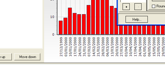

I understand your explanation but if that is the case and if there are no bugs then one would expect the same behaviour to be present regardless of the series type. Consider the code and chart at the end of this post, it is exactly the same as the bar sample except with a line series, the labels align perfectly with the points.
In any event I can't help feeling that the basic design in this process (specifically for bars) is flawed. Considering the following image
06-08-2010 05-04-55.png (7.14 KiB) Viewed 154457 times
It shows the left most bar with a label of 27 Dec, all be it slightly misaligned but never the less the bar has a label showing the 27th Dec. This is plainly wrong as the true date for this bar is the 26th. This wouldn't be a problem so much if the series was a line series as line series are used to show continuous data. It's generally the shape of the entire line that is of interest and people understand that they must drop down from the point of interest on the line to the axis and infer what date it relates to. Bars are different in that they are used to show discrete observations with the label under the bar being (in our case) the date at which that discrete observation occured. Looking at the example above most (if not all) people would assume that the bar is for the 27th Dec when in fact it's for the 26th.

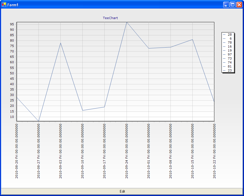

I am looking at ways I can get my application to automatically assign custom label values when an axis is Datetime and a standard increment has been set but I really think tchart should be doing this automatically.
 Private Sub InitializeChart()
      TChart1.Clear()
      TChart1.Aspect.View3D = False
      Dim Line = New Steema.TeeChart.Styles.Line(TChart1.Chart)
      Line.XValues.DateTime = True
      TChart1.Axes.Bottom.Labels.Angle = 90
      TChart1.Axes.Bottom.Labels.DateTimeFormat = "yyyy-MM-dd ddd HH:mm:ss.fffffff"
      TChart1.Axes.Bottom.Increment = Utils.GetDateTimeStep(DateTimeSteps.OneWeek)
      Dim rnd = New Random
      Dim dte = New DateTime(2010, 8, 20, 0, 0, 0, 0)
      Dim y As Double
      For i As Integer = 0 To 9
         CType(Line, Steema.TeeChart.Styles.Line).Add(dte, rnd.[Next](100))
         dte = dte.Adddays(7)
      Next
produces the following chart

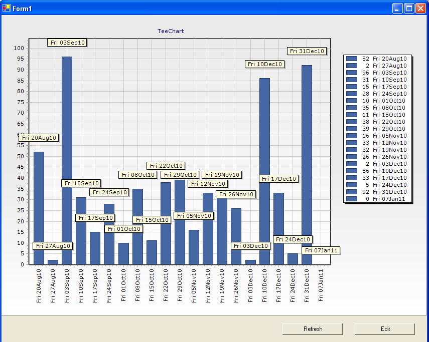

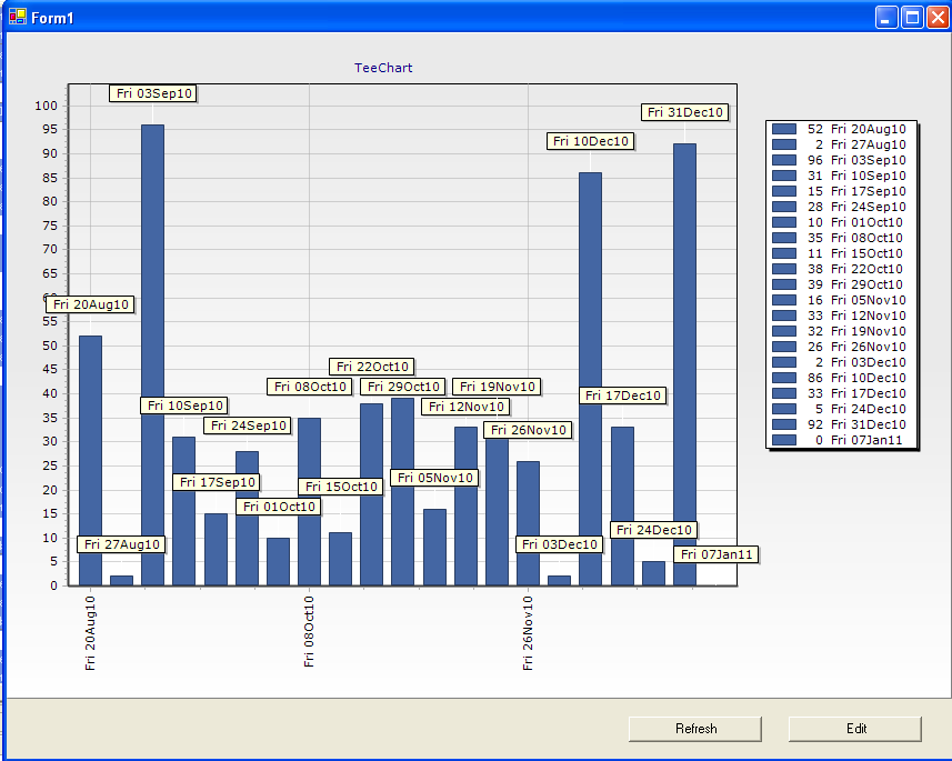

I'm trying to implement a solution to this issue using custom labels but am running into some more issues. Im using the following code

      bar.XValues.DateTime = True
      TChart1.Axes.Bottom.Labels.DateTimeFormat = "ddd ddMMMyy"
      Dim y As Double
      For i As Integer = 0 To 20
         CType(bar, Steema.TeeChart.Styles.Bar).Add(dte, rnd.[Next](100), CDate(dte).ToString("ddd ddMMMyy"))
      Next
   Private Sub Button1_Click(ByVal sender As System.Object, ByVal e As System.EventArgs) Handles Button1.Click
      TChart1.ShowEditor()
   Private Sub btnRefresh_Click(ByVal sender As System.Object, ByVal e As System.EventArgs) Handles btnRefresh.Click
      InitializeChart()
End Class
which results in the following chart
which on the face of is seems to resolve my problem however if I resize the window slightly with the mouse I get the following
Most of the labels dissapear. I'm really hoping to be able to resolve this issue this week by using something simmilar to the sample code, I'll just detect whether the axis is datetime and if so apply custom formatting. It should all work correctly apart from this strange behaviour when resizing. The problem also sometimes appears when the chart is first displayed, i.e. without first resizing.
Any suggestions.
Adrian.

A little more information, The problem with the dissapearing labels only seems to occur if there are 15 or more bars, less than 15 bars and the problem dosen't appear.

Post by Yeray » Tue Aug 10, 2010 2:17 pm
Hi Captell,
Since you are adding the points with label, and you are showing it in the Bottom axis, you don't need to set any Increment and you won't probably need to add the points with XValue.
This works fine for me here:
            Steema.TeeChart.Styles.Bar bar = new Steema.TeeChart.Styles.Bar(tChart1.Chart);
            bar.XValues.DateTime = true;
            tChart1.Axes.Bottom.Labels.DateTimeFormat = "ddd ddMMMyy";
            //tChart1.Axes.Bottom.Increment = Steema.TeeChart.Utils.GetDateTimeStep(Steema.TeeChart.DateTimeSteps.OneWeek);
            Random rnd = new Random();
            DateTime dte = new DateTime(2010, 8, 20, 0, 0, 0, 0);
            for (int i = 0; i < 20; i++)
                //bar.Add(dte, rnd.Next(100), dte.ToString("ddd ddMMMyy"));
                bar.Add(rnd.Next(100), dte.ToString("ddd ddMMMyy"));
                dte = dte.AddDays(7);
However I think adding the points with DateTime XValue shouldn't cause problems here. I've added it to be investigated for future releases (TF02015083).

My application allows the user to use the chart editor to set properties on axes and other stuff in the chart. They also get to set what data is plotted, i.e. they set up their own database queries and then chart the resultant data. As the "problem" with the axes lables not lining up on bar charts is forcing me to manually add the labels I think don't think we can ignore the increment setting.
The users will naturally set the increment when they create a bar chart, just like they do when they create a line chart. Can this be added to the list of things to look at please. I'd also like to see these issues looked at with some degree of urgency. At the moment I have users creating bar charts where the label under the bar (ok not directly centered under the bar but never the less under the bar) is not the actual date of the data represented by the bar.
Adrian Heald
