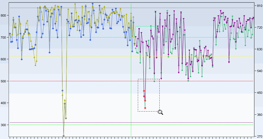

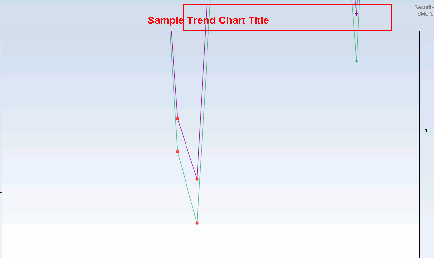

Post by Chris.CHWU » Tue Jul 07, 2009 7:06 am
Greetings,
I enabled the zooming tool after highlighting but met some problems.
The line associated with the highlighted points would be drawed outside the chart region.
Before zooming:
before zooming
After zooming:
after zooming
Do you have any iedas about this?
Re: Selection of series' points
Post by Sandra » Tue Jul 07, 2009 10:17 am
Hello Cris,
I have commented two things:
First:
Is possible that you have property tChart1.Aspect.ClipPoint= false, change this for true. I check with last version and works fine.
Second: If previous not works, please you could say what is your actualy version of TeeChartFor .Net?
If your version isn't laster, please update the version and tester code.If the problem still appears you can send a simple example because we can reproduce here. Now,you can attach your projecte direcly in the forums post.

                        X1 = e.X;
                        Y1 = e.Y;
                tChart1.Invalidate();
        void line_GetPointerStyle(Steema.TeeChart.Styles.CustomPoint series, Steema.TeeChart.Styles.GetPointerStyleEventArgs e)
            e.Style = Steema.TeeChart.Styles.PointerStyles.Circle;
            if (Selected[e.ValueIndex])
                e.Color = Color.Red;
        private void ResetCoords()
            X0= -1;
            Y0= -1;
Please, check that previous codes works correctly in your application.
I hope will helps.
