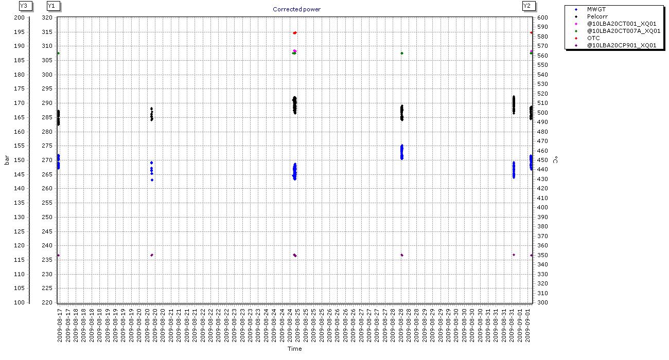

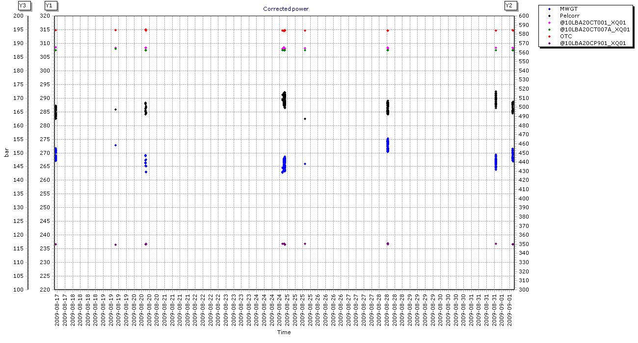

We have been using the .NET versions of TeeChart for a few years now.
With a recent version of our application that we released we are seeing a significant difference in the points that are visible when a graph is drawn to the screen in our application.
The data is all present in the Series objects in the graph but when the graph is drawn with no lines but with symbols at the points visible (with a small size for the circle symbols) in an older version we can see more of the points without zooming in then we can in a new release.
The 2 versions that we are using are the following:
Older version: 3.2.2945.19738 from Jan 24 2008
Newer version: 3.5.3371.26406 from March 25 2009
With the Jan 2008 version on an unzoomed graph we see a full rendering of the points that are included in the data series on the graph.
With the March 2009 version on the same unzoomed graph in the same resolution setting we see places in the graph where data was previously visible with the older version but with the newer version it is not visible until you zoom in on the location where you know there should be data.
The graphs only contain 1954 total points each.
Did any rendering algorithms change for TeeChart or for the underlying OS level graphics calls possibly?
Our users were a bit concerned that data they could previously see is now no longer visible since we updated to a more recent version.
Thank you for any answers you can provide on this issue.

- This image is generated with the Jan 2008 3.2 version of TeeChart for .NET
- ImageFromOlderVersion.jpg (189.09 KiB) Viewed 12198 times
- This image is generated with the March 2009 3.5 version of TeeChart for .NET
- ImageFromNewerVersion.jpg (187.85 KiB) Viewed 12198 times

I am doing a lot of investigation into this issue since our users have a lot of problem with the fact that there is data missing from our graphs.
It appears to be related to the TREATNULLS property.
The old version that we used to use was back when Series had the IGNORENULLS property and we set it to TRUE.
The way we use NULLS is we add points to the series and set them to NULL when we want the line to NOT be connected between 2 points.
**EDIT** Rewording this section so it is more clear and accurate to our process.
For example if we have a point at 8:00:00AM and the next valid data point is at 8:50:00AM.
We will add a NULL point with the same Y value but with the X 1 second after the 8:00:00 point (at 8:00:01).
This user to cause the graph to "pick-up the pen" and NOT draw the connecting line between the 2 points that are valid.
This worked in the old version that we used to use just fine.
Now, it seems that when we have points very close together and one is a NULL index, there are situations where even the valid point is not drawn.
I use the .TREATNULL property = .DoNotPaint. That seems to be the only setting that provides a similar function to the way we used to use NULLS.
This is a critical part of our application. We filter data and use the NULLs to indicate where the line should be broken.
When you turn off the LinePen.Visible property (using a Custom data series) and set the Pointer.Visible = true, we should get just the symbols drawn at the points that are NOT null. But we are seeing some of the points next to the NULL indexes not being drawn when the graph is fully unzoomed.
If you zoom in on the graph, the proper points are shown. So we know the data is in the series and recognized. But there is some problem with the display of the data.
If I change the TREATNULL property to Skip or Ignore, the points show up on the unzoomed graph properly but when the line is drawn it does not perform the way it used to. It draws the line between all the points and does not treat the NULL ones as breaks in the line any more.
I hope this makes some sense.
I am trying to produce a small test app to show this functionality to you first hand.
Any ideas? Recommendations? Better descriptions of how to use the TREATNULL property to accurately duplicate the way the IGNORENULL property used to work? The help documentation doesn't really help at all.
Aaron

I have a sample app I will be emailing to the support address.
I will include in the email a link to this thread.
The problem seems to be with TreatNulls and the way we previously used the IgnoreNulls property.
When points are VERY close together, it seems that a NULL value is causing a good value to either not be drawn or be overwritten on screen with an empty point causing the display to not show the good value.
