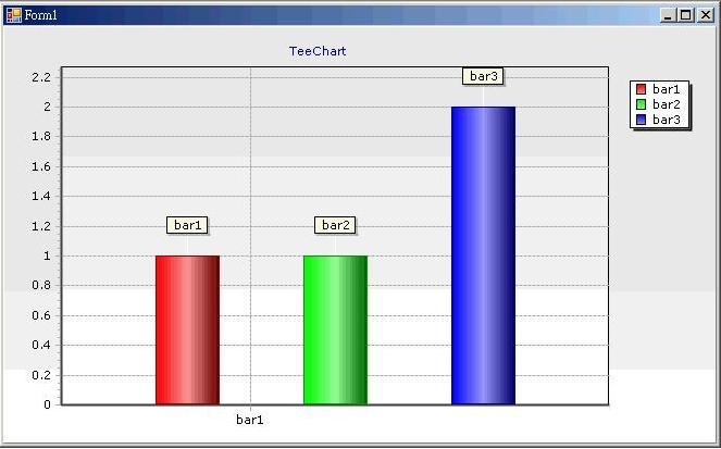

Here is another issue I encountered after I upgraded to new version teeChart: 3.5.3498.27367

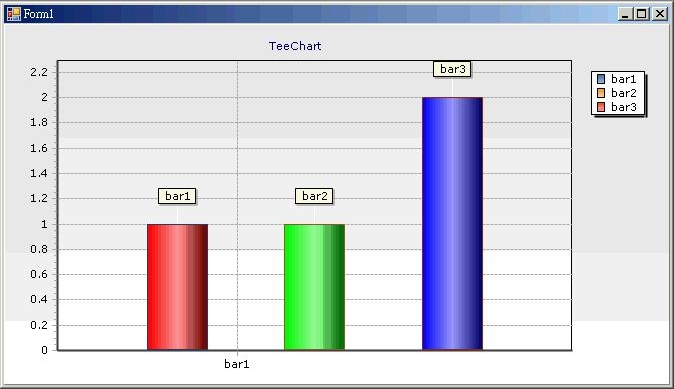

In new version: 3.5.3498.27367, the bar and legend have mismatch issue in bar chart I draw.
You could see that in the below image. The red is bar1 in chart, but it is shown as bar3 in chart legend. The blue is bar3 in chart, but it is shown as bar1 in chart legend.
But in old version: 3.5.3065.19161, the bar and legend match correctly in bar chart I draw.
The following is the source code we use to create the bar chart, please help to fix the issue as soon as possible. Thank you so much.

Post by Yeray » Tue Sep 22, 2009 11:15 am
Hi Chris,
I've found that the fix for the bug TF02013556 broke this. I've added this to be revised for further releases (TF02014433).
In the meanwhile you could try setting the BarStyle to Rectangle and trying to achieve a similar effect customizing the gradients Start, Middle and End colors.
Re: Encounter bar and legend mismatch issue after upgrade
Post by Yeray » Thu Sep 24, 2009 8:35 am
Hi Chris,
As an update to this, I'd like you to know that this has been fixed, so it will be available with the next TeeChart NET v2009 maintenance release.
