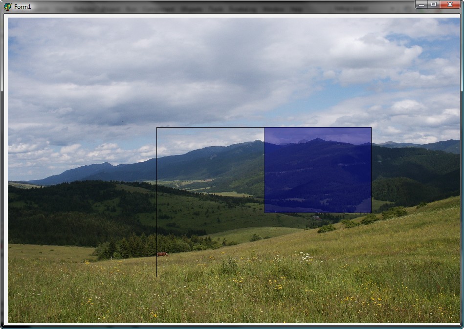

Thank you for sending me the project. When I run it, I get the result shown in the attached image - definitely not showing a map series with transparent chart background. I am using Delphi 2009 with Vista. Any help would be appreciated.

I'm not sure to understand what you mean. I see a map series, and I see the image behind the chart. Could you please explain what you are exactly trying to achieve?

You are quite right; the demo project does work correctly.
I am saving files in PNG, TIFF and GIF formats. My hope is that in those saved images the chart background could be transparent.
