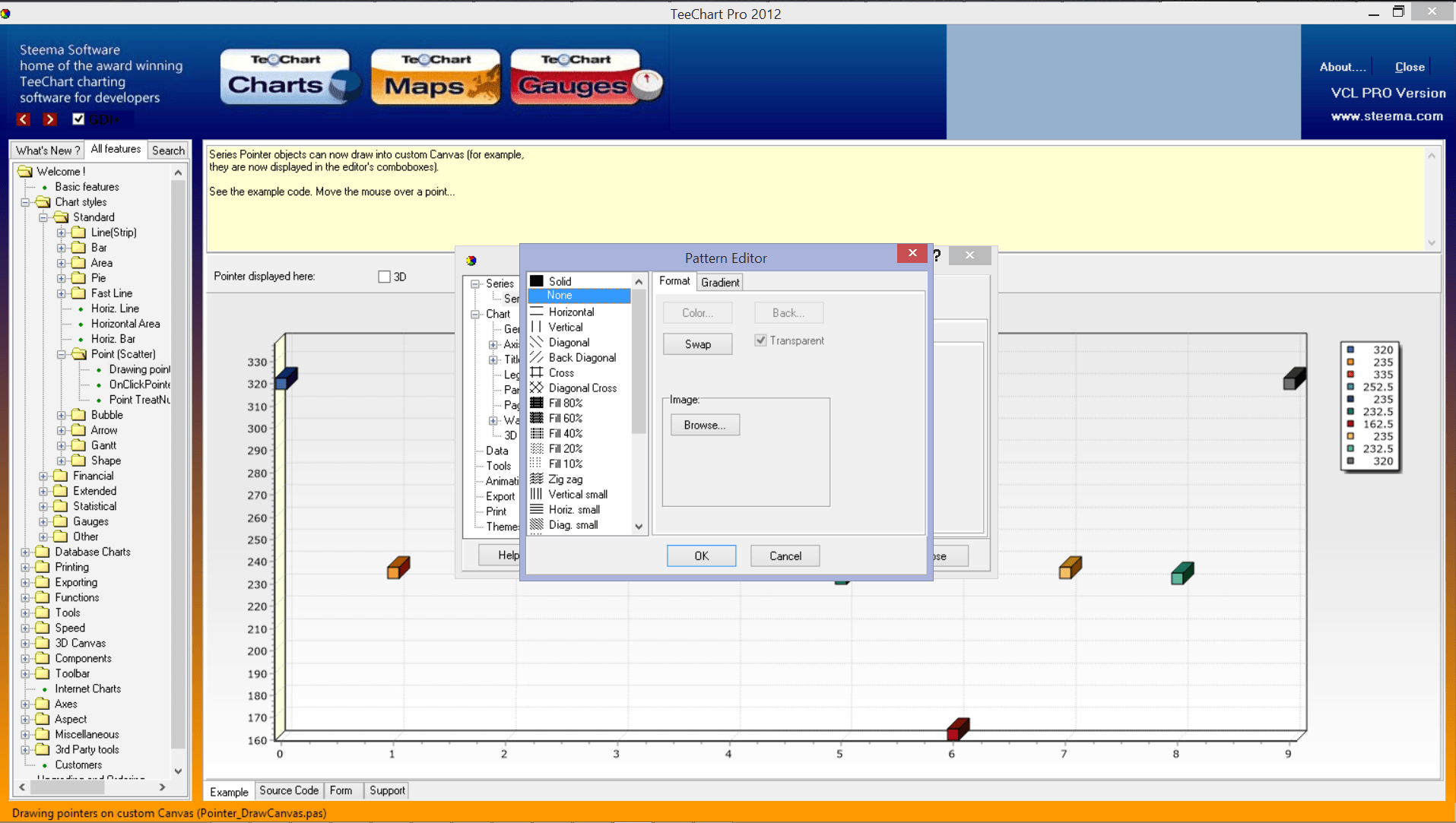

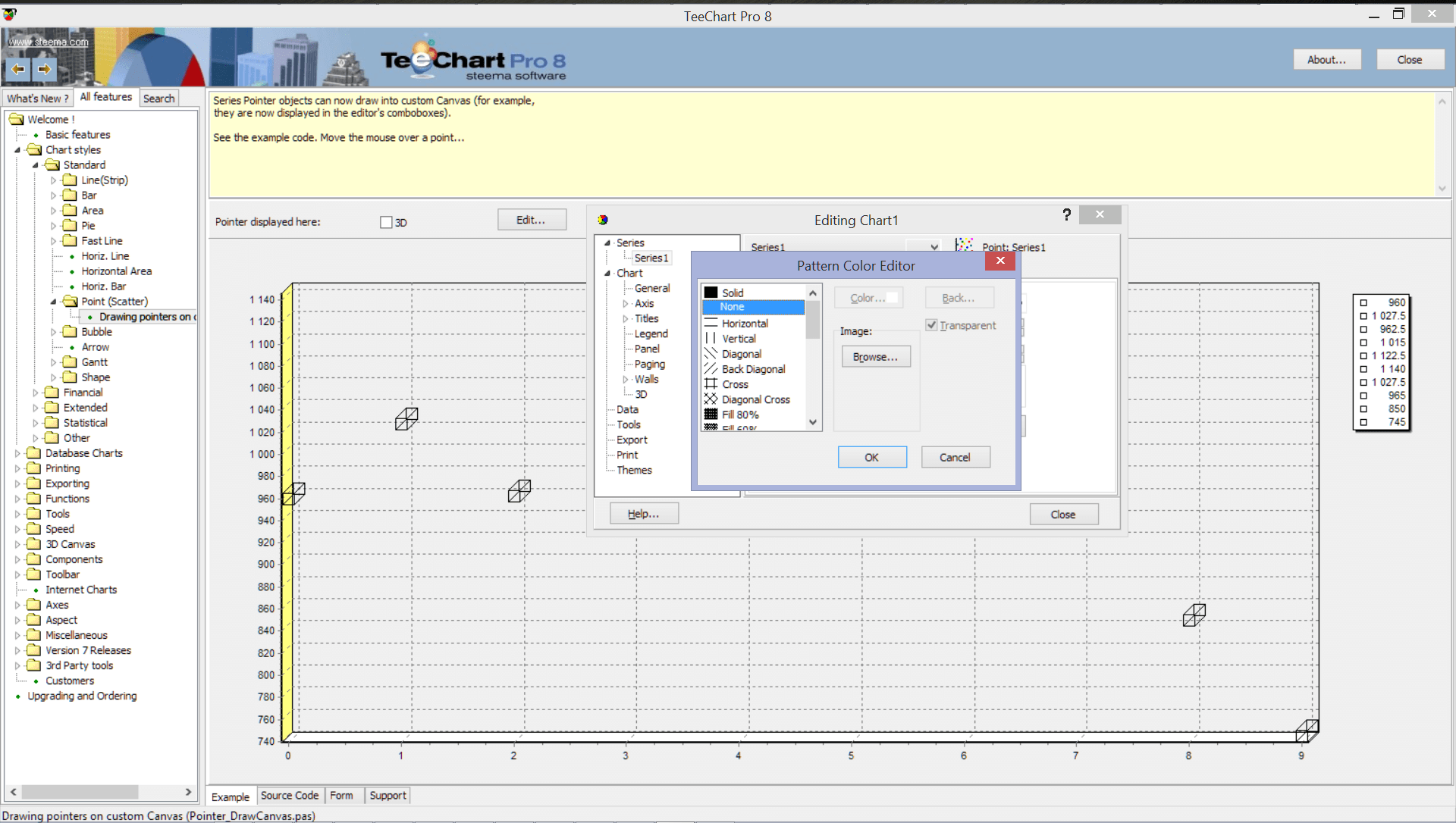

I'm afraid this feature isn't available now, at least at design time. I tried to achieve it by both Chart Editor and Object Inspector but out of success. To prove it I tried to do the same things in pre-compiled Tee8New and Tee9New demos. Is this expected feature change or a bug?

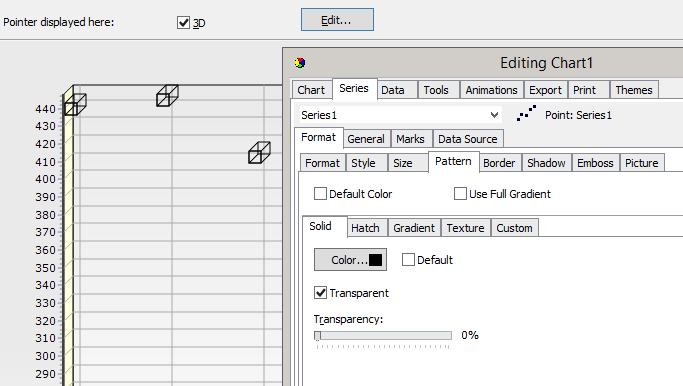

In the actual version, TeeChart v2015.14 I can achieve it both through the editor and by code:
- Through the editor, set the point to be transparent:
