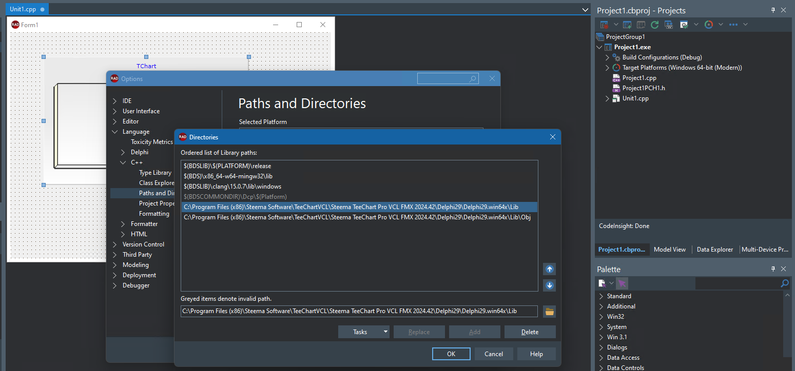

I do find the components compiled for Win32 and Win64 binary compatible with 12.3, but for Win64x (Modern) I get the error
"Unit VCLTee.TeeTools was compiled with a different version of VCLTee.Chart.TTextShape". Running TeeRecompile solved the problem.
Update: Issue is maybe not on TeeChart side. Embarcadero Migration Tool seems not yet to handle Win64x platform.
Re: RADStudio 12.3 support
Post by Yeray » Tue Mar 18, 2025 8:52 am
That's strange, it seems to work fine for me here:
