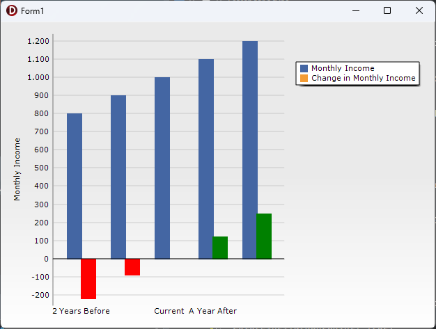

In the attached demo, I have a TChart that has bars, some with negative values.
The image is visible here: https://app.screencast.com/iyBZFNk6yvUsB
I have two items I need help with.
1) For the first red bar with a negative value, there is no margin between the red and the axis--how do I create a margin between the red bar and the line at the bottom?
2) For the left axis, I want the zero value line to be the darker/heavier line, and the other lines to be lighter.
How can I achieve this?

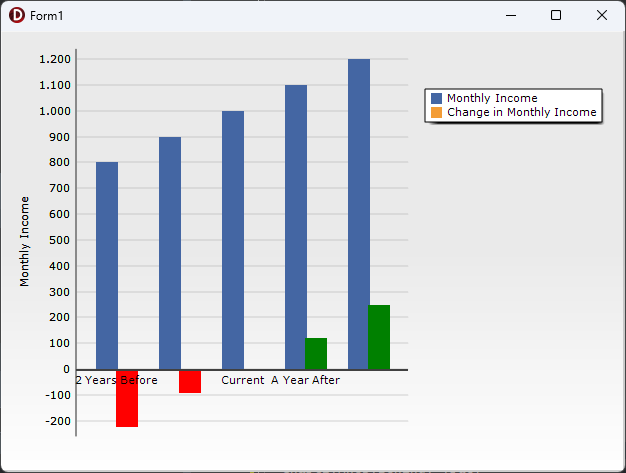

Thank you. That works well--but is there any way to move the series labels (e.g. "2 Years Before") below the chart, rather than overwriting the series)?
