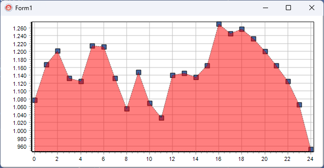

Post by Yeray » Thu Sep 19, 2024 6:34 am
All the drawing methods in the canvas use screen coordinates.
Here you have an example using PolygonFloat function:
uses Chart, TeEngine, TeCanvas, Series;
var Chart1: TChart;
  Chart1:=TChart.Create(Self);
  with Chart1 do
    Parent:=Self;
    Align:=alClient;
    Color:=clWhite;
    Gradient.Visible:=False;
    Walls.Back.Color:=clWhite;
    Legend.Hide;
    View3D:=False;
    AddSeries(TPointSeries).FillSampleValues;
    OnAfterDraw:=ChartAfterDraw;
procedure TForm1.ChartAfterDraw(Sender: TObject);
var
  series: TChartSeries;
  polygon: Array of TPointFloat;
  tmpBlend : TTeeBlend;
  i: Integer;
  if Chart1.SeriesCount<1 then
     Exit;
  series:=Chart1[0];
  if series.Count<2 then
     Exit;
  SetLength(polygon, series.Count+2);
  for i:=0 to series.Count-1 do
    polygon[i].x:=series.CalcXPos(i);
    polygon[i].y:=series.CalcYPos(i);
  polygon[i].x:=polygon[i-1].x;
  polygon[i].y:=Chart1.Axes.Bottom.PosAxis;
  Inc(i);
  polygon[i].x:=polygon[0].x;
  polygon[i].y:=polygon[i-1].y;
  tmpBlend:=Chart1.Canvas.BeginBlending(Chart1.ChartRect, 50);
  Chart1.Canvas.Pen.Style:=psDash;
  Chart1.Canvas.Brush.Color:=clRed;
  Chart1.Canvas.PolygonFloat(polygon);
  Chart1.Canvas.EndBlending(tmpBlend);
