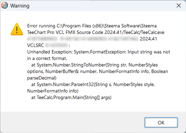

I downloaded the latest installer 2024.41 and got the following error message after entering the licence information and pressing next:
TeeChart 2024.41 install error message.png (115.92 KiB) Viewed 41889 times
I am running Windows 11.

Post by Yeray » Tue Sep 17, 2024 12:34 pm
Hello Peter,
Please make sure you copy each field in the correct box and without blank spaces.
