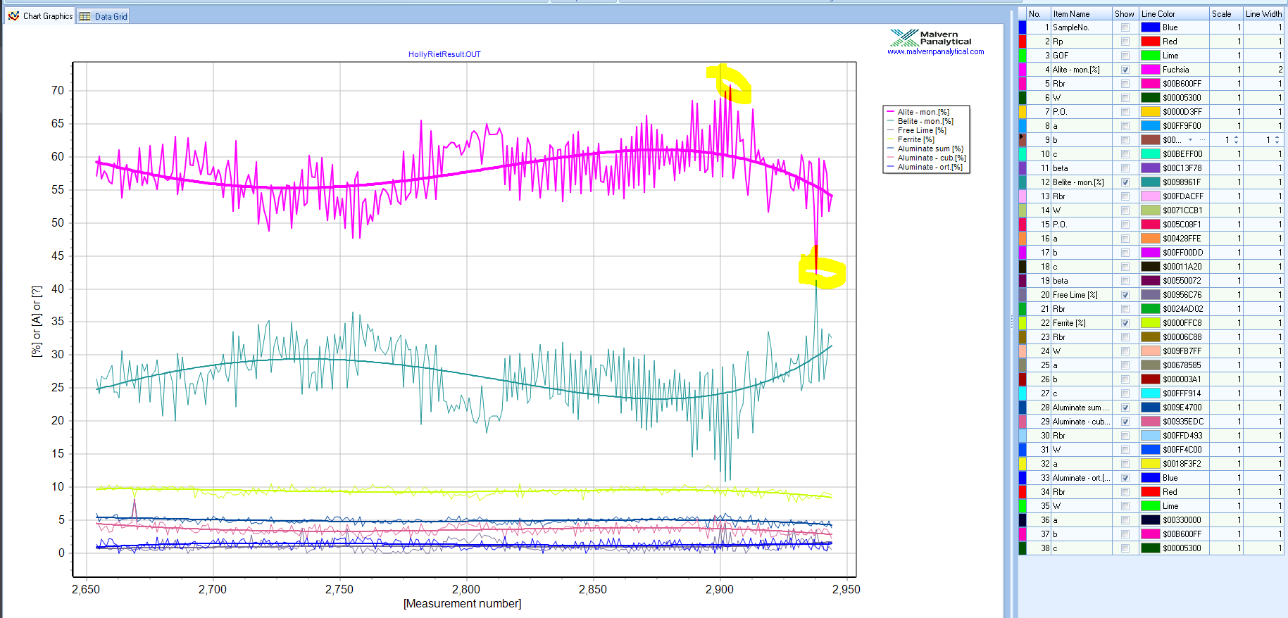

We often show process values/parameters using multiple Line series:
Now we want to highlight values per Line series that are outside certain user given min/max limits. Is there a TChart Tool or a certain Series for that, or do we need to develop our own tool for that? Like drawing something on the Canvas in the OnAfterDraw event of the Chart etc.

Post by X-ray » Mon Aug 19, 2024 5:12 pm
Hello Yeray,
Thanks for the Tip, but all these lines add too much "Noise" to the graphics. I am now creating an extra TPointSeries that contains the violating Points as Yellow semitransparent circles. So the graphics only gets more populated with "stuff" in case there are min/max violations.

Re: How to best show/highlight series values that are hitting min/max limits?
Post by Yeray » Tue Aug 20, 2024 6:44 am
Of course drawing the horizontal threshold line(s) is just an option.
Also note it's simpler if you only want to draw pointers where the values are out of the range; the tricky part in that example was to change the line pen between the in-range and the out-range points.
