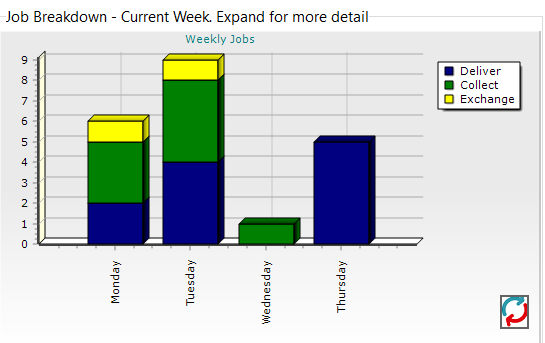

Ive added an image to show how I want it. Maybe its best to manipulate the datasource instead whihc is what I;ve done in the designer?

I've created a series for each JObtype requested - Code below. I've hard coded until I fully understand how it works.
Screenshot 1chart2.png (16.57 KiB) Viewed 36731 times
. However the resulting chart shows an extra series on Tuesday that I'm not adding and also a value for Wednesday, when I passed 0.
I've attached the chart image.
Andy

Re: Understanding bars and series
Post by Yeray » Mon Nov 27, 2023 12:34 pm
The Add function appends a value to the series value list, regardless of the label you are assigning to it.
That's the reason why the second value added in S3 is shown in the second bar, even if it's label is 'Thursday'. And the same for the third value in S2.
You should add the same number of values to all the series, so they can be stacked at the positions you expect them. To do so, you can add a zero (as you are doing in the first series for 'Wednesday') or a null, ie:

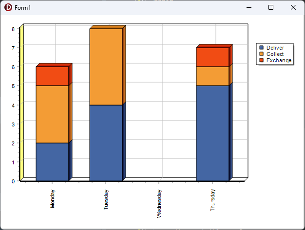

To do it automatically, you'll need to create a series for each of the "jobs" you have, and then you can loop the "weekDays" you want to track and search in your data structure and your series and add the value for matching that weekDay, or a zero if none.
I created a simple example with a couple of dirty records to emulate your data structure. This part should be accommodated to your datasource.
Then, I'm creating the series and looping the weekDays as indicated above.

And this is what I get with the example above:
