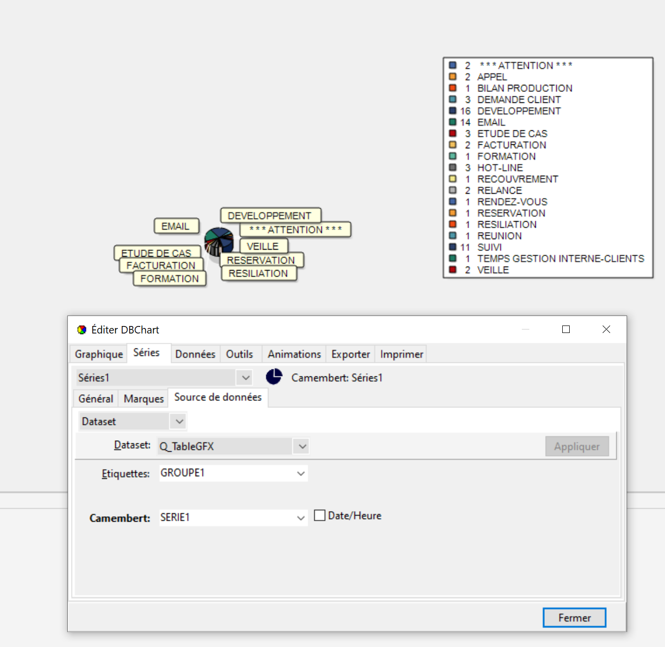

In an empty project it's work fine. It's display my (multiple record) dataset.

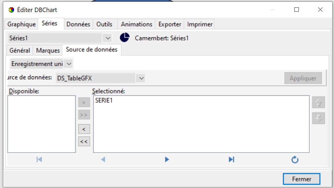

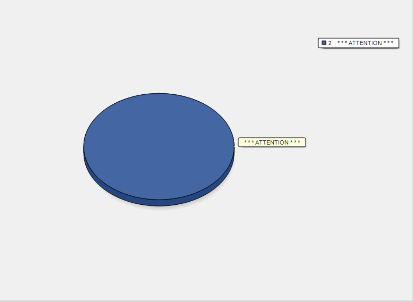

But in my 7 millions of line of code program with the same code my TDBChart display a Single record like this :
and result :
But I want = If I edit (in runtime) my TDBChart to connect to a dataset it's work :

Why my TDBChart display it datasource as "Single record" and not as a (multi-record) dataset ?
In other words of to force a dataset or a single record dataset ?

Ok I have understand my mistake.
It's if you connect DBChart1.Series[0].DataSource to a TDatasource component (connected to a Tdataset) !
Strangely in this case it display a "single record" ?!
