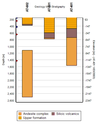

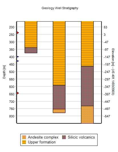

In my previous topic, I was asking about the correct horizontal placement of a title above a self-stacked bar chart. In this post, I would like to be able to set the vertical position of the title just above the top axis of the bar chart, and have it remain there on scroll or zoom operations. As shown in the attached images, the title scrolls off the top of the chart at present if I use CalcBarBounds, or disappear entirely if I zoom the chart.
Any suggestions much appreciated.

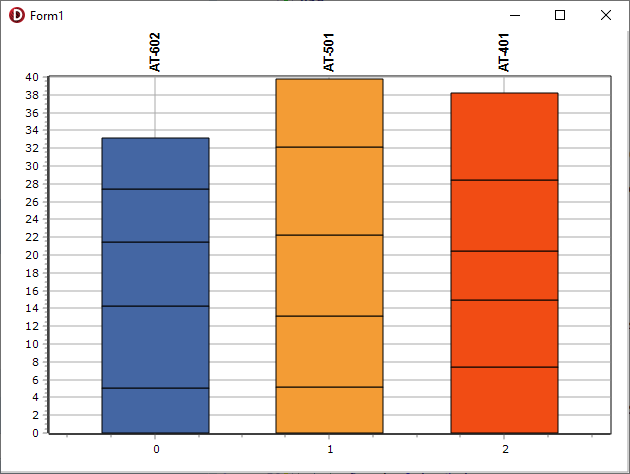

Post by Yeray » Fri Dec 09, 2022 6:17 pm
Taking the code from the reply I just wrote there, I've modified it to also calculate the value for the TAnnotationTool.Top property to position them just above the ChartRect:
uses Series, TeeTools;
const aWellName: array[0..2] of string = ('AT-602', 'AT-501', 'AT-401');
var i, j: Integer;
  Chart1.Title.Hide;
  Chart1.View3D:=False;
  Chart1.Color:=clWhite;
  Chart1.Legend.Hide;
  for i:=0 to 2 do
    with TBarSeries(Chart1.AddSeries(TBarSeries)) do
      MultiBar:=mbSelfStack;
      Marks.Hide;
      for j:=0 to 4 do
        Add(5+Random*5);
    with TAnnotationTool(Chart1.Tools.Add(TAnnotationTool)) do
      Shape.CustomPosition := true;
      Shape.Pen.Color := clWhite;
      Shape.Transparent := true;
      Shape.Font.Size := 10;
      Shape.Font.Style := Shape.Font.Style + [fsBold];
      Shape.Angle := 90;
      Text := aWellName[i];
      OnBeforeDraw:=AnnotationToolBeforeDraw;
  Chart1.MarginTop:=10;
  Chart1.Draw;
procedure TForm1.AnnotationToolBeforeDraw(Sender: TObject);
var i: Integer;
  for i:=0 to Chart1.Tools.Count-1 do
    if Sender = Chart1.Tools[i] then
      PlaceWellNames(i);
      Exit;
procedure TForm1.PlaceWellNames(AIndex: Integer);
var
  LLeft, LWidth: integer;
  LAcross: integer;
  annot: TAnnotationTool;
  bar: TBarSeries;
  if Chart1.Tools[AIndex] is TAnnotationTool then
    annot:=TAnnotationTool(Chart1.Tools[AIndex]);
    bar:=TBarSeries(Chart1[AIndex]);
    // centre of bar
    LLeft := bar.CalcXPos(0) + (bar.BarWidth div 2);
    LWidth := annot.Width;   // width of shape
    LAcross := LWidth div 2;   // half title width
    annot.PositionUnits := muPixels;
    annot.Left := LLeft - LAcross;  // this is correct for non-automatic scaling
    annot.Top := Chart1.ChartRect.Top - LAcross - 10;
