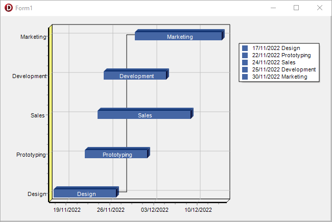

Your animated GIF illustrates exactly the 'problem'. The gap between gantt bars is increasing/decreasing as the tchart resizes.
My boss doesn't want that behaviour. He wants the gap between bars to be fixed, regardless of the height of the tchart.

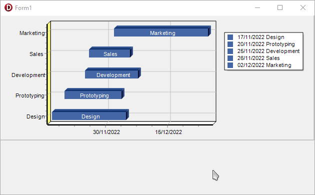

It sounds as changing Chart1.Align property from alClient to ie alTop:

The distance between gantt bars depends on the number of values to be drawn and the axis size, which depends on the chart height.
Also note the Pointer.VertSize (the size of the gantt bars) also affects how this looks.
FGanttSeries.Pointer.VertSize:=12;
