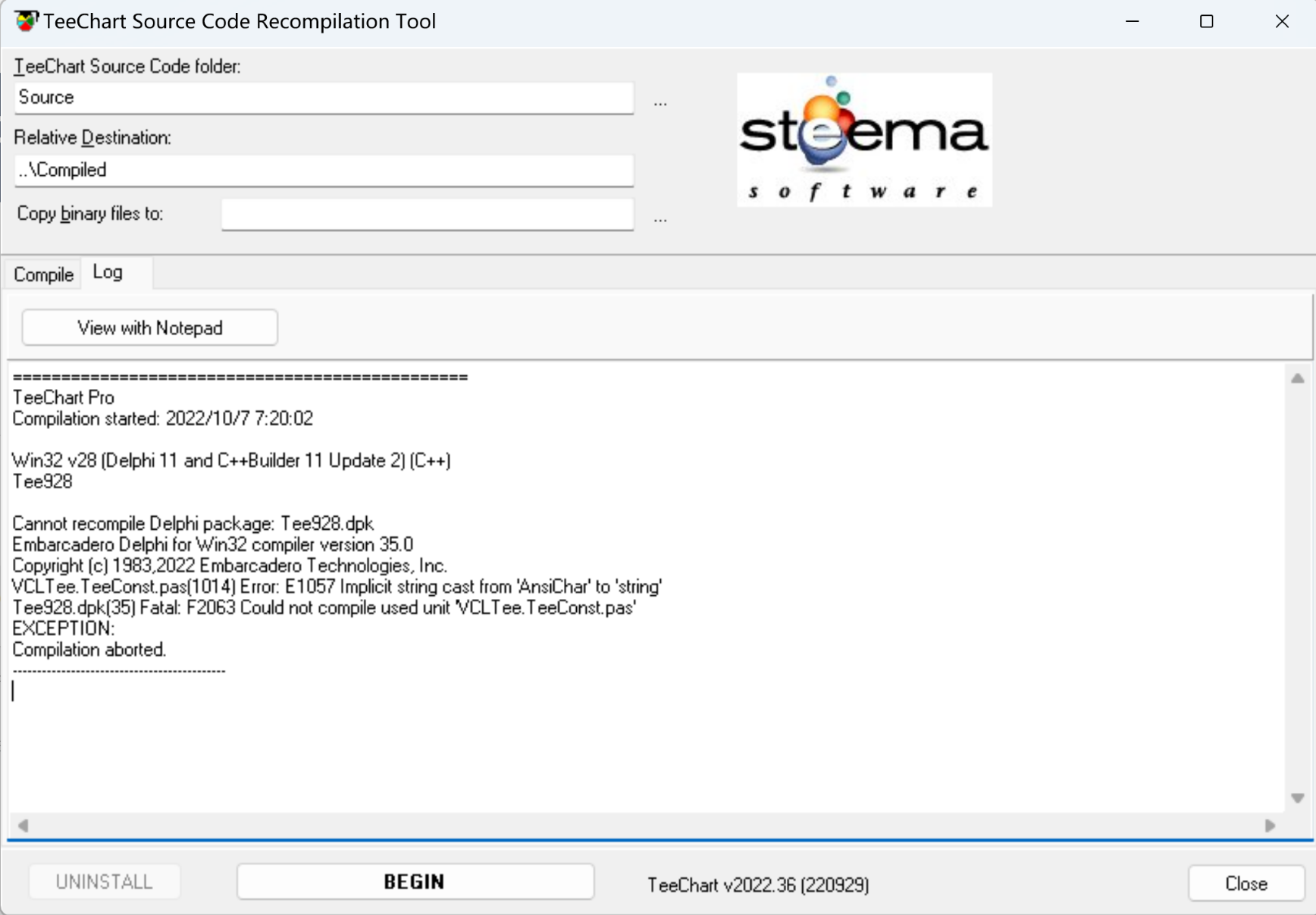

When I installed the source file program, it was prompted to compile, and it started to execute after I modified the path, but an error occurred:
TeeChart Pro
Compilation started: 2022/10/6 18:39:16
Win32 v28 (Delphi 11 and C++Builder 11 Update 2) (C++) ERROR
Tee928
Compiling...
"C:\Program Files (x86)\Embarcadero\Studio\22.0\bin\dcc32.exe" -$D+ -$L+ -$W+ -$O- -$C- -$Y+ -$C+ -$R+ -$Q+ -GD -V -VT -VN -W^ -H -$A8 --no-config -u"C:\Program Files (x86)\Embarcadero\Studio\22.0\Lib\win32\Release" -u"C:\Program Files (x86)\Embarcadero\Studio\22.0\Lib\win32\Release\Indy10" -nsSystem;WinAPI;VCL;System.Win;VCL.Imaging;Data;BDE;Datasnap;XML;VCLTee -LN"C:\Program Files (x86)\Steema Software\Steema TeeChart Pro VCL FMX Source Code 2022.36\Source\..\Compiled\Delphi28.win32\Lib" -E"C:\Program Files (x86)\Steema Software\Steema TeeChart Pro VCL FMX Source Code 2022.36\Source\..\Compiled\Delphi28.win32\bin" -N0"C:\Program Files (x86)\Steema Software\Steema TeeChart Pro VCL FMX Source Code 2022.36\Source\..\Compiled\Delphi28.win32\Lib" -U"C:\Program Files (x86)\Steema Software\Steema TeeChart Pro VCL FMX Source Code 2022.36\Source\..\Compiled\Delphi28.win32\Lib";"C:\Program Files (x86)\Embarcadero\Studio\22.0\Lib\win32\Debug";"C:\Program Files (x86)\Steema Software\Steema TeeChart Pro VCL FMX Source Code 2022.36\Source\VCL" -I"C:\Program Files (x86)\Steema Software\Steema TeeChart Pro VCL FMX Source Code 2022.36\Source\VCL" -R"C:\Program Files (x86)\Steema Software\Steema TeeChart Pro VCL FMX Source Code 2022.36\Source\VCL" -O"C:\Program Files (x86)\Embarcadero\Studio\22.0\Lib\win32\Debug" -M -DBCB --BCB -CG -JPHNE -JL -NO"C:\Program Files (x86)\Steema Software\Steema TeeChart Pro VCL FMX Source Code 2022.36\Source\..\Compiled\Delphi28.win32\Lib\Obj" -NH"C:\Program Files (x86)\Steema Software\Steema TeeChart Pro VCL FMX Source Code 2022.36\Source\..\Compiled\Delphi28.win32\Include" -NB"C:\Program Files (x86)\Steema Software\Steema TeeChart Pro VCL FMX Source Code 2022.36\Source\..\Compiled\Delphi28.win32\Lib\Obj" -LN"C:\Program Files (x86)\Steema Software\Steema TeeChart Pro VCL FMX Source Code 2022.36\Source\..\Compiled\Delphi28.win32\Lib" "C:\Program Files (x86)\Steema Software\Steema TeeChart Pro VCL FMX Source Code 2022.36\Source\VCL\Tee928.dpk" -LE"C:\Program Files (x86)\Steema Software\Steema TeeChart Pro VCL FMX Source Code 2022.36\Source\..\Compiled\Delphi28.win32\System"
Cannot recompile Delphi package: Tee928.dpk
Embarcadero Delphi for Win32 compiler version 35.0
Copyright (c) 1983,2022 Embarcadero Technologies, Inc.
VCLTee.TeeConst.pas(1014) Error: E1057 Implicit string cast from 'AnsiChar' to 'string'
Tee928.dpk(35) Fatal: F2063 Could not compile used unit 'VCLTee.TeeConst.pas'
EXCEPTION:
Compilation aborted.
Does anyone know where the problem is?

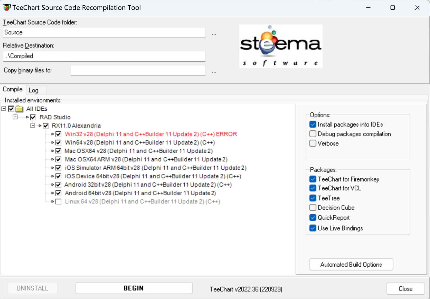

Thanks for the reply.
I still encountered the same error message after re-downloading and installing, my IDE version is RAD Studio 11.2 Patch 1 (28.0.46141.0937).

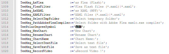

Could you please check if the line 1014 in the "Source\TeeConst.pas" is as follows?
TeePolarDegreeSymbol :='°';
Re: Cannot recompile Delphi package: Tee928.dpk
No, in notepad++ it looks like gibberish:
- TeeConst.pas
- TeeConst.png (19.32 KiB) Viewed 13512 times
- VCLTee.TeeConst.pas
- VCLTee.TeeConst.png (19.44 KiB) Viewed 13512 times

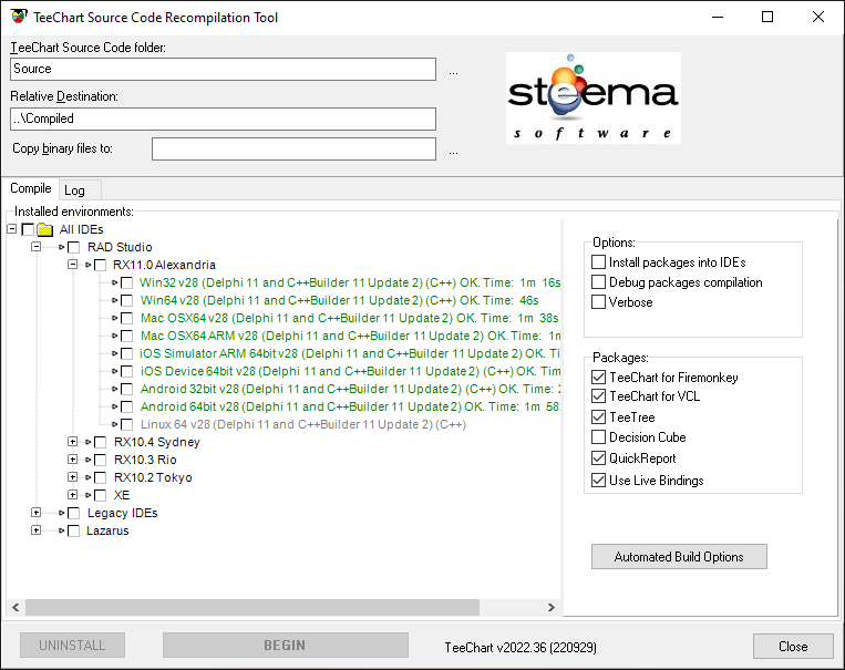

Indeed, we detected some unicode issues with Chinese machines. We'll revise that.
In the meanwhile, you should be able to correct the "Source\TeeConst.pas" is as follows and run TeeRecompile:
Line 612:
Line 1014:
Line 612:
TeeMsg_Copyright :={$IFDEF LCL}'(C)'{$ELSE}'©'{$ENDIF}+' 1995-2022 by Steema Software';

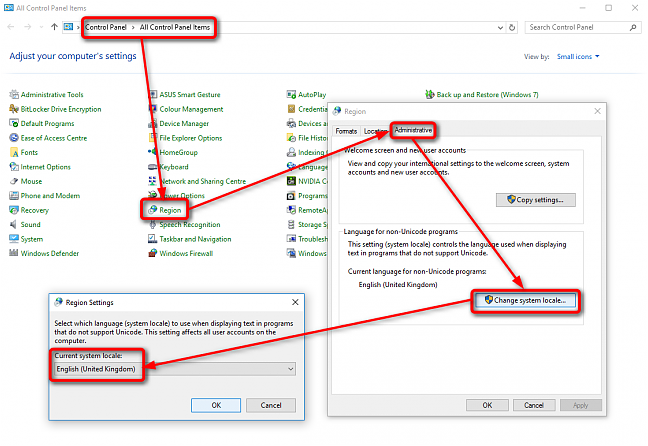

An alternative is to change your system locale as follows:
