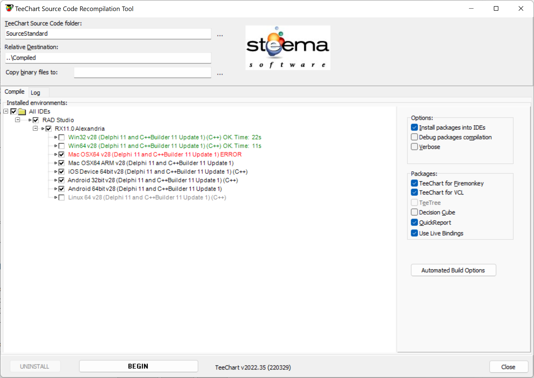

I am trying to build my standard dev environment on a new Windows 11 machine and Delphi 11.1 Alexandria Enterprise. When installing TeeChart from TeeChartVCLFMXStandardSOURCE-2022.35.exe I am getting an error when attempting to install MAC OSX 64bit. Error log is below. I have tried installing with elevated privileges and even a clean install of Delphi with no other libraries added, still this problem persists.
It may have been asked before but haven't managed to find any clear work around for this - can anyone advise to what's happening and a workaround/
Neil

Mac OSX64 v28 (Delphi 11 and C++Builder 11 Update 1)
FMXTee928
Cannot recompile Delphi package: FMXTee928.dpk
Embarcadero Delphi for Mac OS X 64 bit compiler version 35.0
Copyright (c) 1983,2022 Embarcadero Technologies, Inc.
Linker command line: "C:\Delphi\11.1 Alexandria\bin\ld.exe" -arch x86_64 -o "C:\Delphi\11.1 Alexandria\Steema\TeeChart\SourceStandard\..\CompiledStandard\Delphi28.osx64\System\bplFMXTee928.dylib" -e __ZN9Fmxtee92814initializationEv -dead_strip -dead_strip_dylibs -mark_dead_strippable_dylib -exported_symbols_list "C:\Delphi\11.1 Alexandria\Steema\TeeChart\SourceStandard\..\CompiledStandard\Delphi28.osx64\System\FMXTee928.exp" -dylib -export_dynamic -S -x -macosx_version_min 10.9 -F \System\Library\Frameworks -F \System\Library\PrivateFrameworks -L "C:\Delphi\11.1 Alexandria\Lib\osx64\Release" -L "C:\Delphi\11.1 Alexandria\Redist\osx64" -L "C:\Delphi\11.1 Alexandria\Steema\TeeChart\SourceStandard\FMX" -rpath $ORIGIN -install_name @rpath/bplFMXTee928.dylib -filelist "C:\Delphi\11.1 Alexandria\Steema\TeeChart\SourceStandard\..\CompiledStandard\Delphi28.osx64\System\FMXTee928.lnk"
Error: E2597 ld: warning: directory not found for option '-L/usr/lib'
ld: warning: directory not found for option '-F\System\Library\Frameworks'
ld: warning: directory not found for option '-F\System\Library\PrivateFrameworks'
ld: warning: directory not found for option '-F/System/Library/Frameworks/'
ld: file not found: /usr/lib/libiconv.dylib
Fatal: F2588 Linker error code: 1 ($00000001)
EXCEPTION:
Compilation aborted.

Please confirm that you have set a MacOS64 connection profile and with the SDK in the IDE with which to compile.

Have you created a MacOS64 connection and a profile in the SDK Manager in the IDE as Marc suggested above? The compiler needs that cache to build for MacOS64. See the steps here.
