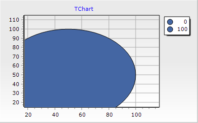

I'm not sure to understand the situation. The shape series is clipped by default in the chartrect so the axes labels are always shown in a simple example for me here:

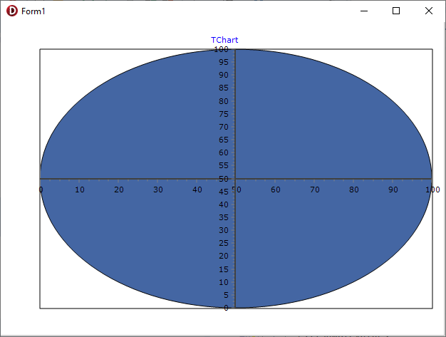

You may be interested on the axes PositionPercent, PositionUnits and the Chart's AxisBehind properties.
Ie:
uses TeeShape;
  with Chart1 do
    View3D:=False;
    Legend.Hide;
    Gradient.Visible:=False;
    Color:=clWhite;
    Walls.Back.Color:=clWhite;
    with Chart1.AddSeries(TChartShape) do
      FillSampleValues;
      Color:=OperaPalette[0];
    Chart1.AxisBehind:=False;
    Chart1.Axes.Bottom.PositionUnits:=muPercent; //muPixels,muPixels;
    Chart1.Axes.Left.PositionUnits:=muPercent; //muPixels,muPixels;
    Chart1.Axes.Bottom.PositionPercent:=50;
    Chart1.Axes.Left.PositionPercent:=50;
    Chart1.Axes.Bottom.Grid.Hide;
    Chart1.Axes.Left.Grid.Hide;
