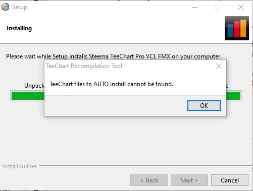

I am getting the following error when installing. (Install Error1.jpg)
Install Error1.jpg (26.13 KiB) Viewed 18248 times

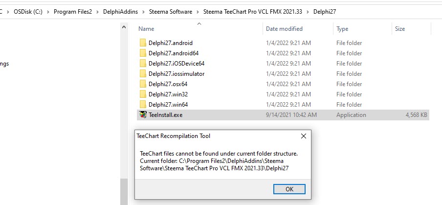

I let it finish and tried to install "TeeInstall.exe" and it also gave an error "TeeChart files cannot be found under current folder structure" (InstallError2.jpg)
Install Error2.jpg (58.01 KiB) Viewed 18248 times
Re: Install Error - TeeChart Files to AUTO install cannot be found
Post by Yeray » Wed Jan 05, 2022 7:00 am
It works for me from the "Delphi27" folder but we'll revise that.
In the meanwhile, could you please try to move TeeInstall.exe to "Delphi27.win32" and run it from there?
