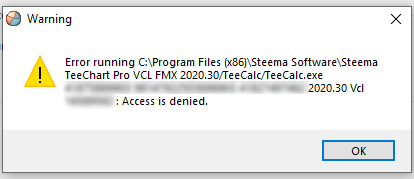

I have downloaded all three packages available (VCL-FMX, VCL-FMX Starter and Source). The behavior outlined below is true for all three:
a) Start installation package (Run as Administrator)
b) enter license number and password
c) install fails with the following message regarding teecalc
Alternatively, the following works:
b) proceed with an unregistered package
c) install completes successfully, however TEEchart is unregistered.
I also checked other posts in the forum that reference Teecalc and but could not figure out what caused the problem or how to resolve it.

Post by Yeray » Tue Oct 06, 2020 12:27 pm
We'll send you a zipped installation if you tell us what IDE are you using.

Post by Zach A » Tue Oct 06, 2020 12:40 pm
I am using Sydney 10.4.1
I also have XE7 installed (with Teechart 2015 and Quickreports), but will leave this one alone for now.

Post by Yeray » Thu Oct 08, 2020 6:26 am
I've just sent a mail with a private download link.
