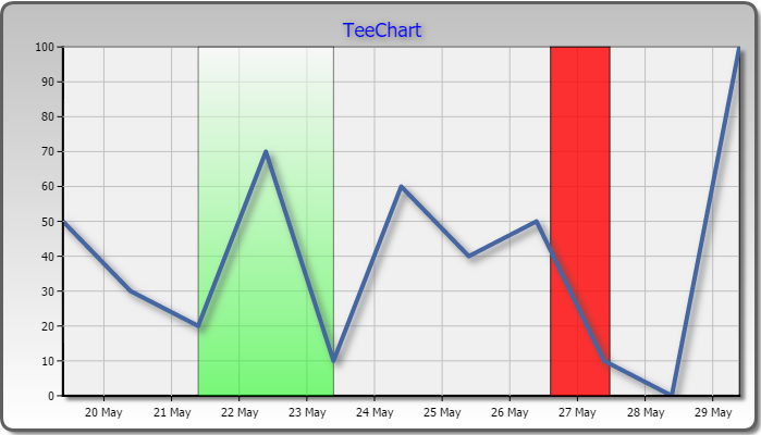

First of all note the Custom Paint example in the demo draws a rectangle/shape. Here I modified it to draw an horizontal ColorBand:
http://www.teechart.net/support/viewtop ... 043#p71201
Taking that as a reference, I've modified the example to use datetime values for the bottom axis, and to draw two vertical ColorBands.
Note I've used slightly different approaches to draw them. The fist one uses a gradient and series values as x1 and x2; the second uses a single color and directly datetimes to calulcate x1 and x2:
        var Chart1;
        function draw() {
            Chart1.legend.visible = false;
            var line1 = Chart1.addSeries(new Tee.Line([50,30,20,70,10,60,40,50,10,0,100]) );
            line1.format.stroke.size=4;
            var oneDay = 86400000, oneHour = 60 * 60 * 1000, today = new Date().getTime();
            line1.data.x = [];
            for (var i=0; i<line1.count(); i++) {
                line1.data.x.push(new Date(today + i * oneDay));
            Chart1.axes.bottom.labels.dateFormat = "dd mmm";
            Chart1.axes.bottom.increment = oneDay;
            var myFormat1 = new Tee.Format(Chart1);
            myFormat1.gradient.visible=true;
            myFormat1.gradient.colors=["white","lime"];
            myFormat1.transparency=0.5;
            var myFormat2 = new Tee.Format(Chart1);
            //myFormat1.gradient.visible=true;
            myFormat2.fill="red";
            myFormat2.transparency=0.2;
            line1.beforeDraw=function() {
                var x1 = Chart1.axes.bottom.calc(line1.data.x[2]),
                    y1 = Chart1.chartRect.y,
                    x2 = Chart1.axes.bottom.calc(line1.data.x[4]),
                    y2 = Chart1.chartRect.y + Chart1.chartRect.height;
                // X,Y, Width, Height
                myFormat1.rectangle(x1,y1, x2-x1, y2-y1);
                x1 = Chart1.axes.bottom.calc(today + 7 * oneDay + 5 * oneHour),
                x2 = Chart1.axes.bottom.calc(today + 8 * oneDay + 2 * oneHour),
                myFormat2.rectangle(x1,y1, x2-x1, y2-y1);
            Chart1.draw();

Wow! Perfect! Yeray thanks so much!!!
