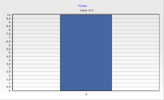

And my second problem is that, as you can see on the chart, when my data source returns only one record, the BottomAxis value is not shown in the middle of the axis, as my dreams would like.
I think the two problems are linked...

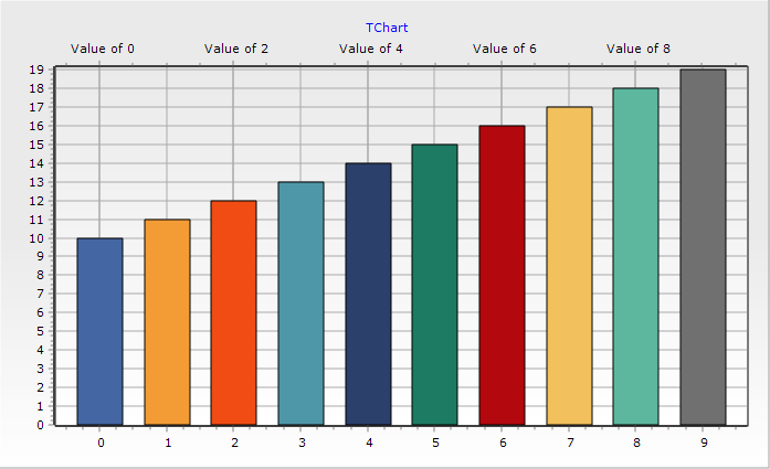

We'd need a simple example project we can run as-is to reproduce the problem here because I see no problems trying to achieve what I'm understanding you described:
uses Series;
procedure TForm1.PopulateSeries(ACount: Integer);
var i: Integer;
  Chart1[0].Clear;
  for i:=0 to ACount-1 do
    Chart1[0].AddXY(i,(i+1*10),'Value of ' + IntToStr(i));
procedure TForm1.BMultipleValuesClick(Sender: TObject);
  PopulateSeries(10);
procedure TForm1.BSingleValueClick(Sender: TObject);
  PopulateSeries(1);
  Chart1.View3D:=False;
  Chart1.Legend.Hide;
  Chart1.Axes.Top.LabelStyle:=talText;
  Chart1.Axes.Bottom.LabelStyle:=talValue;
  with TBarSeries(Chart1.AddSeries(TBarSeries)) do
    ColorEachPoint:=True;
    HorizAxis:=aBothHorizAxis;
    Marks.Hide;

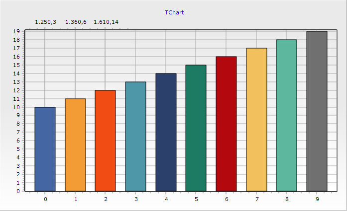

I'm using an array to store the values to be displayed on the top but using a datasource should also work:
var topValues: array of double = [1250.30, 1360.60, 1610.14];
var i: Integer;
  FormatSettings.DecimalSeparator:=',';
  FormatSettings.ThousandSeparator:='.';
  Chart1[0].Clear;
    with Chart1[0] do
    if i<Length(topValues) then
       AddXY(i,(i+1*10),FormatFloat('#,##0.##',topValues[i]))
       AddXY(i,(i+1*10));
odaumas wrote:
Thu Mar 05, 2020 10:19 am
...and when I define TopAxis.Automatic at False,
it don't show anything anymore :( .
You need to set the axis minimum and maximum values when you don't want it to be automatic.

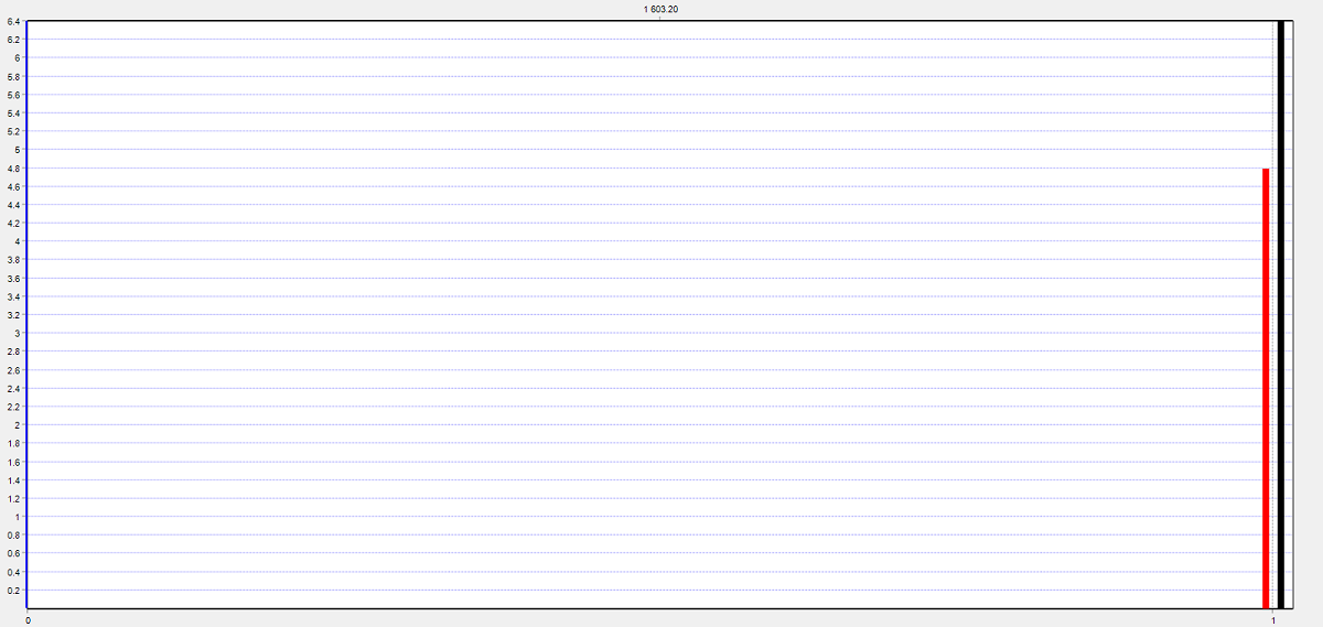

I do a clear chart, before creating the series dynamically.
Maybe I not define something correctly. :roll:
Re: synchronization of two opposite axis
Post by Yeray » Fri Mar 06, 2020 8:01 am
If you still find problems with it, please try to arrange a simple example project we can run as-is to reproduce the problem here.
