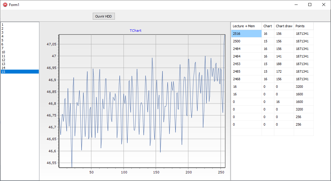

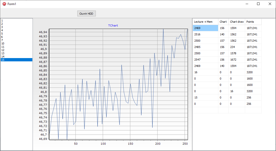

I've added a couple of extra columns to check the drawing speed and the number of values in the series:
var tmpDraw: Int64 ;
procedure TForm1.va(Sender: TObject);
  tmpDraw:= GetTickCount64 ;
  StringGrid1.Cells[2, StringGrid1.RowCount-2]:= IntToStr(GetTickCount64 - tmpDraw) ;
procedure TForm1.ListBox1HddDblClick(Sender: TObject);
  StringGrid1.Cells[2,0]:= 'Chart draw' ;
  StringGrid1.Cells[3,0]:= 'Points' ;
    StringGrid1.Cells[3, StringGrid1.RowCount-1]:= IntToStr(k) ;
Here the results I get:
- Drawing all the points (DrawAllPoints=True):
- Using daMinMax algorithm:
- Using daFirst:
We can see that, for the given data and configuration, the daMinMax algorithm doesn't improve the drawing speed, but the daFirst algorithm has a significant impact on the drawing speed.
