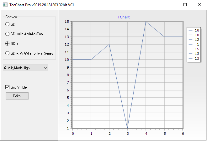

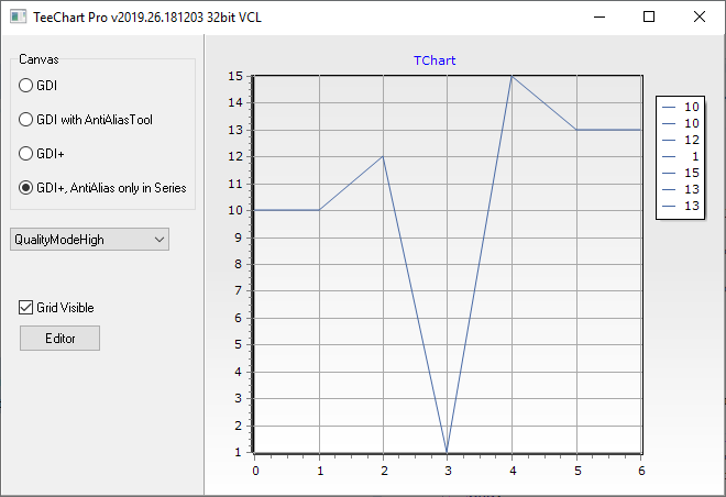

I've just rebuilt the test program from that thread with the current v2018.26 and I can see a difference between "GDI+" and "GDI+, AndtiAlias only in Series" modes:
