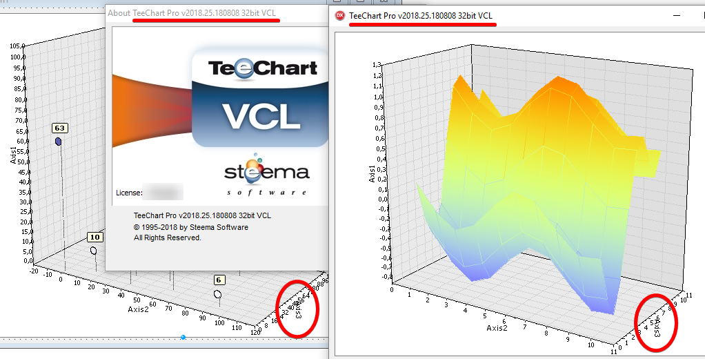

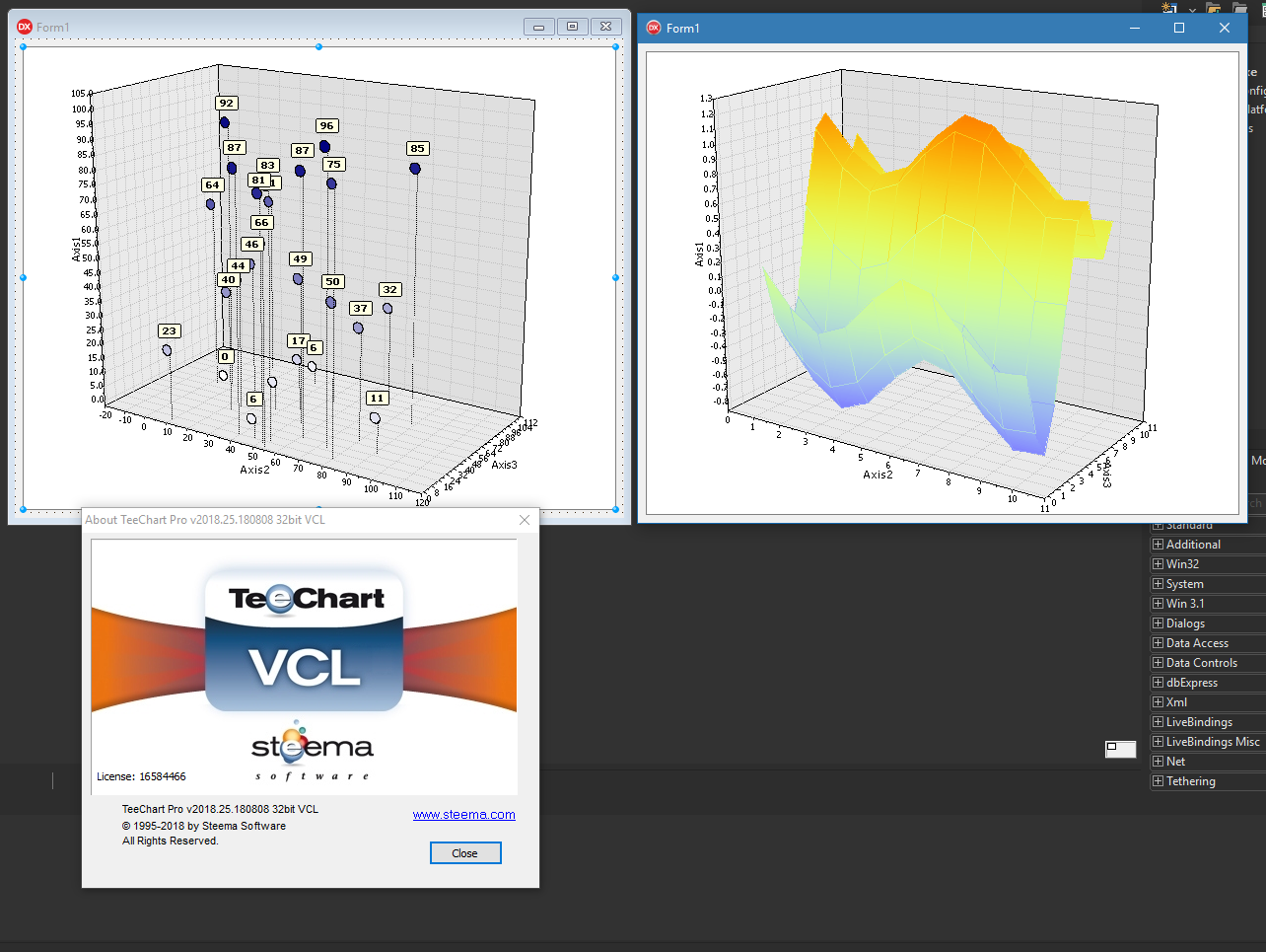

I am using the latest TeeChart version, there seems to be an issue with the depth axis title orientation as there is a difference in the orientation between design time and run time.

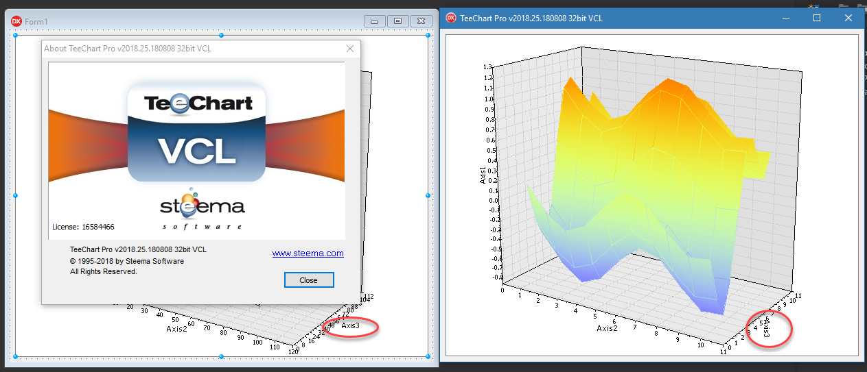

The title of the delphi axis (Axis3) looks the same for me at designtime and at runtime:
Note I've added this to the project to output the TeeChart version that is being used at runtime:
uses TeeConst;
procedure TForm1.FormShow(Sender: TObject);
  Caption:=TeeMsg_Version;
Compare this version with the version the about box gives you at designtime to be sure you are using the same version.

As I already mentioned I am using the latest version ...
