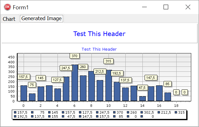

I create images from TCharts to put in my reports (using Digital Metaphors TppReport). Everything is fine when Display/Scale and Input/Change the size of text, apps and other items is at 100%, but when that number changes, all bets are off: fonts appear incorrectly, and the reports simply do not work. It is frustrating.
I have narrowed part of it down to creating imags from TChart (there are some things happening that I haven't quite figured out).
Take a look at the attached demo: when the setting is 100%:
the caption on the chart caption is the correct size (compare it against the size of the TLabel just above it, which is the same font and text):
but when I change it to 200%, the image is rendered without the correct font size:
The report needs the fonts rendered the font size for printing, not for the display settings.
Demo is attached.
Any suggestions on how to get this to work correctly?

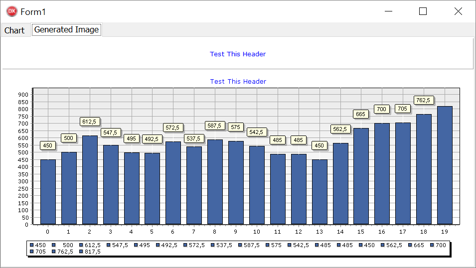

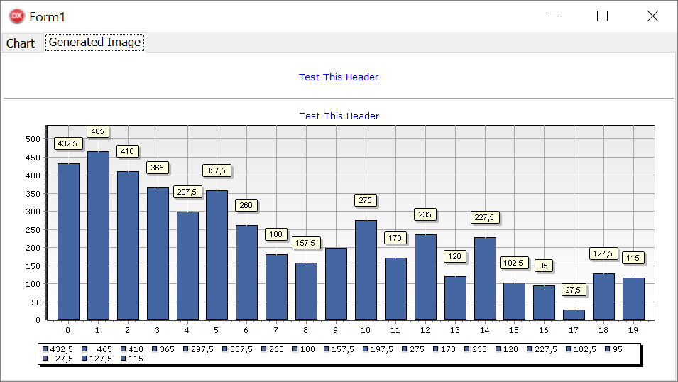

Post by Yeray » Mon May 14, 2018 10:22 am
What TeeChart version are you using?
Fin below my results with TeeChart v2018.24 setting the scale to 150% (I can't set it to 200%).
First I've ran the application and changed the scale "on the fly":
1. onTheFly.png (19.1 KiB) Viewed 38536 times
This is what I get if I close and reopen the application:
2. reopen.png (27.55 KiB) Viewed 38532 times
And this is what I get when I open the application after rebooting at 150%:
3. reboot.png (27.67 KiB) Viewed 38531 times
Ed Dressel
Posts: 28
Joined: Tue Dec 05, 2017 12:00 am
Re: Charts, Images and Display Settings
Post by Ed Dressel » Mon May 14, 2018 2:42 pm
v 2018.24 :-)
I did some testing on different computers in the office and am getting differerent results--and non predictable results. My customers are seeing lots of problems with this.
(The high DPI issues are another issue, which, on some computers, create an image that is ~20% of what it should be).
Any suggestions on how to move this forward?
