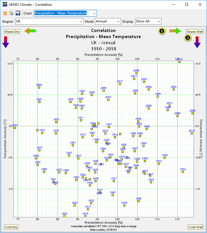

I have placed a number of arrow tools in a chart like this:-
On resizing the chart I want the arrows to remain right-aligned and I though that this code would do it but it causes an exception.

Post by Yeray » Tue Feb 06, 2018 9:11 am
Hello Bruce,
You can use just this:
procedure TfmCorrelationGraph.ChartAfterDraw(Sender: TObject);
  ChartTool8.FromPoint.Point:=Point(Chart1.Width-120, 16);
  ChartTool8.ToPoint.Point:=Point(Chart1.Width-80, 16);
