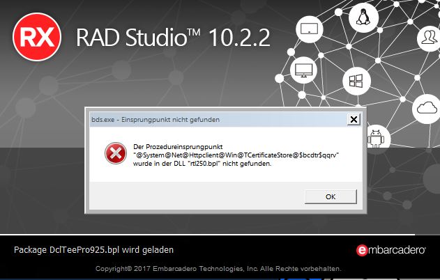

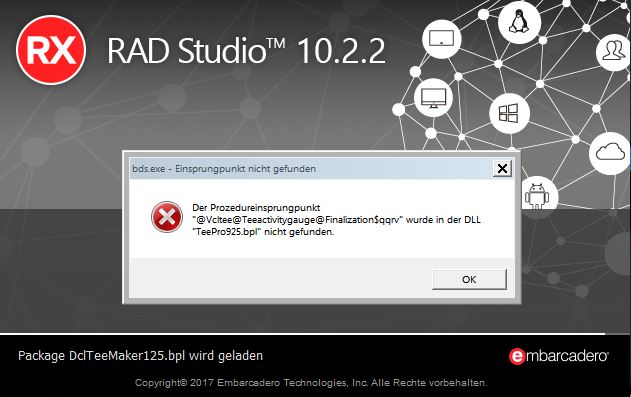

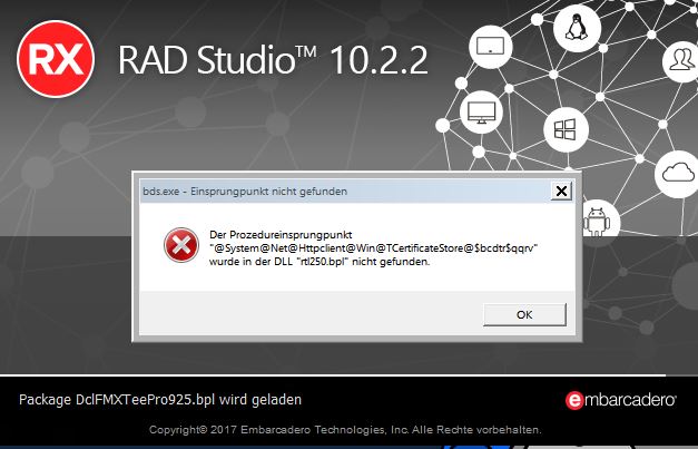

web
Posts: 2
Joined: Thu Mar 30, 2017 12:00 am
Re: Install problems with TeeChart Pro 2017.23 problems
Post by web » Mon Jan 29, 2018 7:55 am
I also tried it without other additional Packages, with and without TeeStandard and the latest TeeChart2017.23 Source Recompile Version.
That happens when i try to Start Delphi:

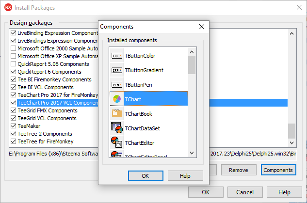

Post by Yeray » Mon Jan 29, 2018 10:32 am
Hello Bruce,
Metman wrote: Although the install seems to works fine it leaves behind the previous TeeChart Std folder in the toolbar palette.
Although it does create a TeeChart folder in the tool palette, the new version of the main TChart component is left behind in the TeeChart Std folder.
If the Pro installation ended successfully, the design time pacakges should have been replaced, even if the TChart component hasn't moved to the new folder in the toolbar. Note you can drag and drop the components in the toolbox.
To know what components you have installed, check the list of packages, not the toolbox.
So, even if the installation should have moved the TChart component to the new folder in the toolbox, if it fails, you can move it manually or you can leave it where it is.
Post by Yeray » Mon Jan 29, 2018 10:35 am
web wrote:I also tried it without other additional Packages, with and without TeeStandard and the latest TeeChart2017.23 Source Recompile Version.
Do you get the same messages if you open the IDE with high privileges (as administrator) and with no project loaded?
Are you using RAD Studio Tokyo Release 2 Starter, Pro, Enterprise or Architect?
