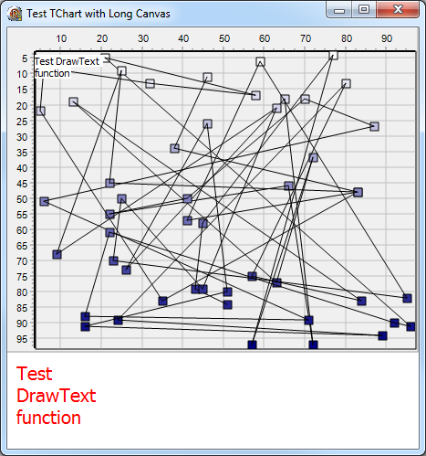

Since i've upgrade my RAD from D2009 to XE10.1 and Teechart from 8.08 to 2017.10, DrawText function (from winapi unit) no longer use canvas settings as font color, size, etc...
Same function on TImage canvas works fine!
Please find attached small project highlighting problem.
I use Delphi XE10.1 and TeeChart Pro VCL FMX Source Code 2017.20.
Thanks for your help
Anthony

Hello Anthony,
It works as always if you switch back from GDIPlus to GDI:
uses TeCanvas;
  Chart.Canvas:=TTeeCanvas3D.Create;

Ok thank, it works finein GDI mode!
Is it planned to fix problem in GDIPlus?
Anthony

We don't have this listed to modify for GDI+. There is the alternative approach using TeeChart's own TextOut.
eg.
Chart.Canvas.Font.Color := clred;
  Chart.Canvas.Font.Size := 15;
  Chart.Canvas.TextOut(r.Left,r.Top,str);
You'd need to add some code to divide up your lines at the spaces.

The use of DrawText being much more powerful than the use of TextOut, isn't the correction of this regression planned yet ?

When using GDI+, TeeChart uses the GDI+ DrawString method internally.
