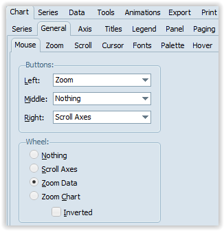

When I open the plot edit tool in my program, I find that under chart | general | mouse one can select 'zoom chart' in the wheel group box (see screenshot below).
How can one do this programmatically?
I have found I can modify properties such as:
  Chart.Zoom.allow := true;
  Chart.Panning.MouseWheel := pmwNone;
  Chart.Zoom.MouseWheel := pmwNormal;
But this just allows one to zoom just the data with the mouse wheel, not the chart. How can one specify zooming the chart rather than just the data?

If you want zoom the Chart instead of Data, you need use Chart1.ZoomWheel property instead of Chart1.Zoom.MouseWheel. You should do the same as next line code:
  Chart1.ZoomWheel:= pmwnormal;
Hoping this helps you.

You should disable the Data Zoom . I have modified your simple code because it works in your end. The modifications are shown below:
chart.Zoom.Allow := true;
Chart.Zoom.MouseWheel := pmwNone;
chart.ZoomWheel := pmwNormal;
Chart.BottomAxis.LabelStyle := talValue;

Excellent - that works!
