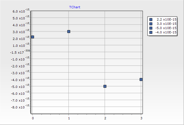

I'm trying to reproduce the problem but I always get all the axis labels drawn.
First, having values in the order of e-15, I get all the labels in the left axis rounded to 0:
uses Series, Math;
const exp = -15;
var base: Double;
  base:=Power(10, 15);
  Chart1.View3D:=False;
  with Chart1.AddSeries(TPointSeries) as TPointSeries do
    Add(2.2/base);
    Add(3/base);
    Add(-5/base);
    Add(-4/base);
  Chart1.Axes.Left.SetMinMax(-9/base, 6/base);
  Chart1.Axes.Left.LabelsExponent:=True;

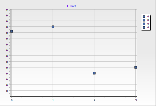

Using ValueFormat and AxisValuesFormat I an see the real values both in the legend and in the left axis labels.
In this case, I still see a label where the '0' should be, but it's represented as a really small value () instead of just '0':
uses Series, Math;
const exp = -15;
var base: Double;
    myValueFormat: string;
  myValueFormat:='#.# x10E-#';
    Add(2.2/base);
    Add(3/base);
    Add(-5/base);
    Add(-4/base);
    ValueFormat:=myValueFormat;
  Chart1.Axes.Left.AxisValuesFormat:=myValueFormat;

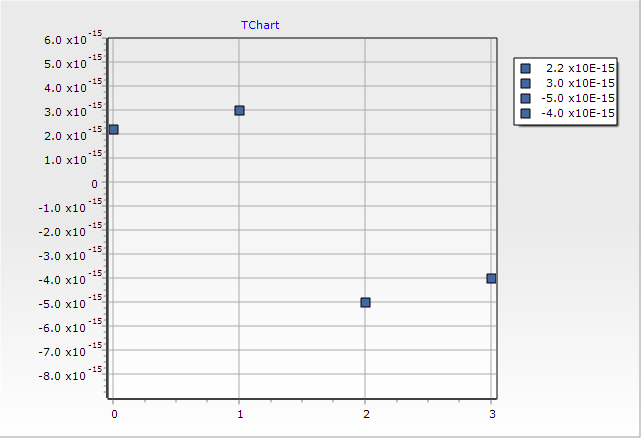

To solve it I can use OnGetAxisLabel event as follows:
procedure TForm1.Chart1GetAxisLabel(Sender: TChartAxis; Series: TChartSeries;
  ValueIndex: Integer; var LabelText: string);
var index, tmpExp: Integer;
  if (Sender=Chart1.Axes.Left) then
    index:=Pos('E', LabelText);
    tmpExp:=StrToInt(Copy(LabelText, index+1, Length(LabelText)));
    if tmpExp<exp then
       LabelText:='0';

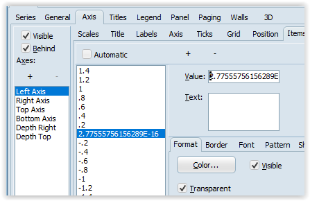

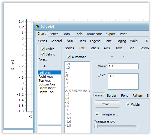

I have also found it difficult to construct a little test program to demonstrate the problem. I have attached screenshots to illustrate the problem and to show the values I find when I use the editor.
The lower plot shows a little of the left axis with the blank where a zero should be. I have overlapped it with the editor displaying chart.axis.items. You can see a strange value where one would expect a 0. The other screenshot shows what one gets after unchecking 'automatic' so I can widen the control so you can see the value (-2.77555756289E-16) that is there.
It looks like some rounding error in stepping from -1.4 to 1.4. Zero comes out a little off.
I hopes this helps clarify the problem.
Screen Shot 11-23-17 at 11.43 PM.PNG (15.69 KiB) Viewed 30305 times
With the control showing the values made wider to the 'zero' value can be seen.
Screen Shot 11-23-17 at 11.42 PM.PNG (25.98 KiB) Viewed 30309 times

Re: zero mark does not always display
Post by Yeray » Mon Dec 04, 2017 7:42 am
JimR wrote:I just tried as an XML file but the forum does not seem to allow one to upload xml files. I just tried the .txt extension and the .tee extensions and they are rejected also. What format should I use?
This exportation allows you to obtain a readable xml output with the objects and properties defined in a chart, but the xml generated can't be imported.
The native option designed to be importable is the .tee, in binary or text format.
You can put the .tee file into a .zip and the forum should allow you to attach it.

I see the Chart1.Axes.Left.AxisValuesFormat is set to '#.##'. Note this AxisValuesFormat is used to convert the axis values to the labels strings, and this returns an empty string:
FormatFloat('#.##', 0);
JimR
Posts: 46
Joined: Mon Oct 24, 2016 12:00 am
Post by JimR » Tue Dec 05, 2017 7:44 pm
OK, I thought it had been still set to the default. I now create the format as needed. Thanks.
Post by Yeray » Mon Dec 11, 2017 7:49 am
Hello Jim,
JimR wrote:I thought it had been still set to the default
By default it should be set to '#,##0.###'.
