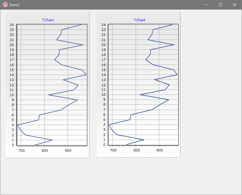

I've tried to reproduce the problem with the following example:
var tmpMetaFile: TMetafile;
  Chart1.View3D:=false;
  Chart1.Legend.Visible:=false;
  with Chart1.AddSeries(THorizLineSeries) as THorizLineSeries do
    Pen.Width:=2;
    FillSampleValues();
  tmpMetaFile:=Chart1.TeeCreateMetafile(True, Chart1.ClientRect);
  Image1.Picture.Graphic:=tmpMetaFile;
But it seems to work as expected for me here both with TeeChart v2015.16 and the current release v2016.18:
We'd need a simple application we can run as-is to reproduce the problem here.
