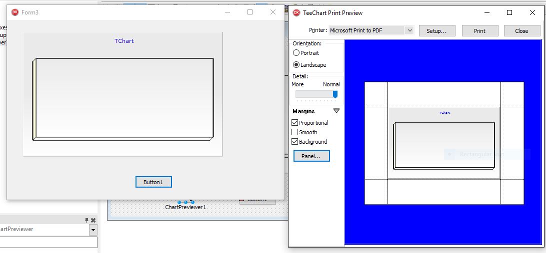

My questions relate to the component TChartPreviewer, not to TTreePreviewPanel. (However, I did try TTreePreviewPanel and it does not "include option buttons" as you state. The reference doc. states that it includes option buttons but I did not find that it did.)
I will try to put my two problems relating to TChartPreviewer differently and more clearly:
(1) The property cpoPrintPanel of TChartPreviewer appears to have no effect on the component behavior. This may be a bug. Please clarify what this property is supposed to do.
(2) There is a facility to customize the Panel in TChartPreviewer, i.e. to make the print look nicer. However, TChartPreviewer scales the chart so that it just fits on the paper, which means that most of the Panel is outside the paper. Please see the figure, where I have colored the Panel area blue. Is it supposed to be possible to print to the edge of the Panel? If so, how?
It occurred to me that the second problem may be something to do with the first.
- Panel Problem.JPG (64.18 KiB) Viewed 11031 times

Hello riskassessor,
Many thanks to clarify the problems.
I have added the as a bug in TeechartVCL bugzilla tracker. Here’s the bug: http://bugs.teechart.net/show_bug.cgi?id=1596
Feel free to add your mail to the CC list of the other tickets to be automatically notified when they'll be updated.
Meanwhile, you can active the Smoothed property to get a correct print output when the cpoPrintPanel is disable.
Anyway, if you disable background option the chart background, the chart should be print with same color as paper TChartPreviewer. As explained above it is a bug.
Hoping this clarify your doubts, otherwise don’t hesitate to contact us.
Thanks in advance
In that case, we have detected a problem when the cpoPrintPanel (Background) isn’t active, basically, if you change the paper color from white to other color, never is reflected in the print output.(1) The property cpoPrintPanel of TChartPreviewer appears to have no effect on the component behavior. This may be a bug. Please clarify what this property is supposed to do.
When you enable property cpoPrintPanel the Chart Panel background is visible and it is printed, otherwise, the ChartPanel is transparent and Chart background color is the same as ChartPreviewer color paper, therefore it should be the print output result.

TChartPreviewer permit customize the aspect the TChartPreviewer and the printer area, but it isn’t reflected in the print output. Therefore you can’t show the ChartPreviewer aspect changes in the print output.(2) There is a facility to customize the Panel in TChartPreviewer, i.e. to make the print look nicer. However, TChartPreviewer scales the chart so that it just fits on the paper, which means that most of the Panel is outside the paper. Please see the figure, where I have colored the Panel area blue. Is it supposed to be possible to print to the edge of the Panel? If so, how?
