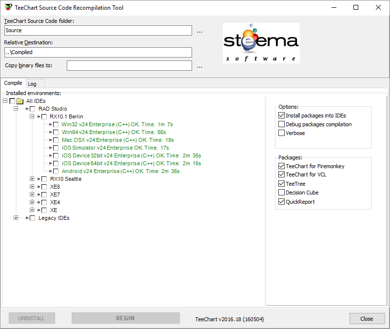

Dave C. wrote:the default folders for source and destination are incorrect
Are you changing the source/destination folders?
This is how it looks for me by default:
If it gives you any compilation error, please open the Log tab to see if there is some extra detail about where does it come from.
