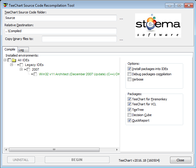

I've just tried TeeChart v2016.18 Source Code version (TeeChartVCLFMXSOURCE-2016.18.exe) in a Virtual Machine with just RAD 2007 installed and it seems to compile and install correctly:
The installer you downloaded may be corrupt so you could try downloading it again. Another possibility (the most probable IMHO) is that your IDE could be broken so I'd suggest you to repair/reinstall it.

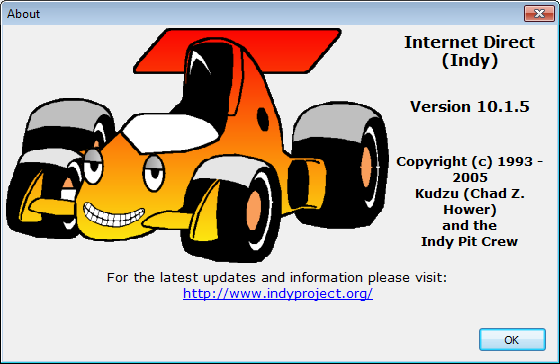

If I remember correctly D2007 came with Indy 9 and for some reason we had to upgrade to Indy 10.

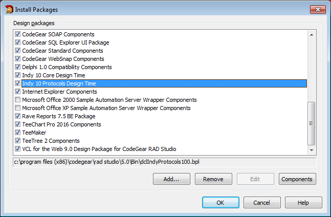

My 'Install Packages' screen looks the same except that the bpl at the bottom is C:\Users\Public\Documents\RAD Studio\5.0\bpl\dclIndyProtocols110.bpl
I also have the Microsoft Office 2000 Sample Automation Server Wrapper Components ticked.

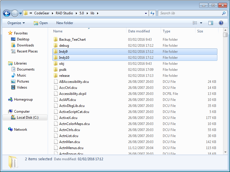

OSNick wrote:If I remember correctly D2007 came with Indy 9 and for some reason we had to upgrade to Indy 10.
The RAD 2007 installation I have in a virtual machine is completely clean and I see both Indy 9 and Indy 10 packages, but Indy 10 packages are the installed into the IDE.

OSNick wrote:My 'Install Packages' screen looks the same except that the bpl at the bottom is C:\Users\Public\Documents\RAD Studio\5.0\bpl\dclIndyProtocols110.bpl
The path "C:\Users\Public\Documents\RAD Studio\5.0\bpl" exists in my virtual machine, but it's empty.
OSNick wrote:I also have the Microsoft Office 2000 Sample Automation Server Wrapper Components ticked.
I can activate it but this is how it was for me by default.
Anyway, I don't think it can affect TeeChart.

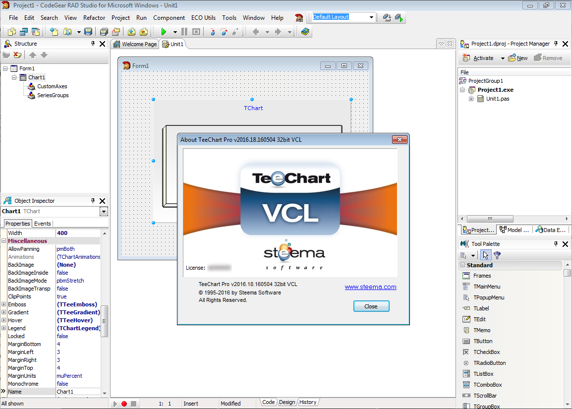

OK, so we removed our copy of Indy components, deleted all traces from the hard drive. Then removed TeeChart. Then from Control Panel, Programs and Features used the RAD Studio installation Modify option which re-downloaded the Indy10 components. After manually adding the browsing path to the dcu's the components loaded OK. Then re-installed TeeChart 2016.18 and it went in fine. I am now going to test the Indy functionality to make sure that everything works. I guess the lesson is not to try to upgrade Indy components if you want to use TeeChart. Still not sure why Teechart v2014 installed without a problem..
Unfortunately the original problems persist but at least we are now on the latest version and I'll start a new thread for that.
