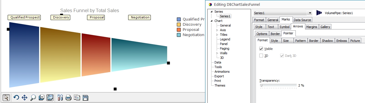

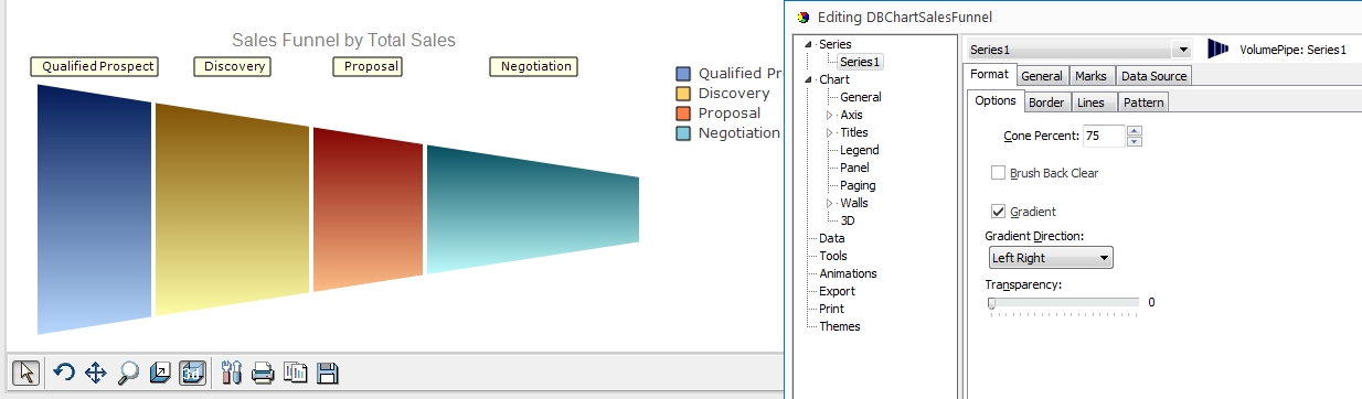

How do I set (or turn off) the gradient in the VolumePipe?
It makes no difference whether Gradient is checked or unchecked or set to Left Right or Top Bottom - the chart looks the same.
Also - how do I set the Maks Arrows for the VolumePipe? Because of the Series Cone Percent, the Mark can be some distance from its segment.
I'm not having much luck getting the Mark's Arrows to show up - above are the placement of the visible Pointers.

MVBobj wrote:How do I set (or turn off) the gradient in the VolumePipe?
I guess the gradient you are trying to disable is the 3D effect. If you set the chart to 2D then you won't see it.
