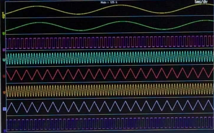

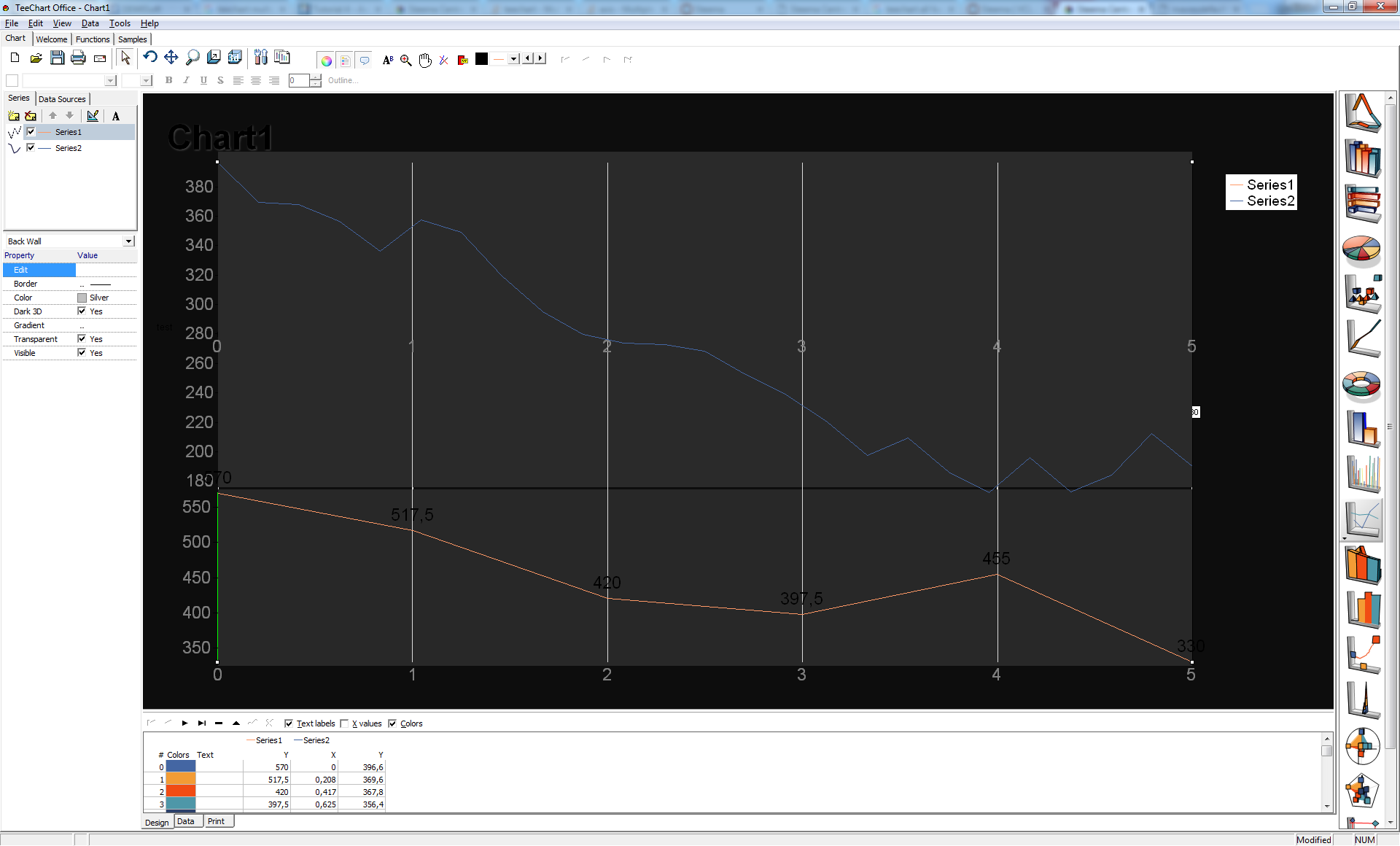

I attached an image of chart I would like to create. There are 8 signals and each has it's own left axis. All 8 signals and axes are on the same chart. Is it possible to do that with teechart? I tried to add axes and move them by changing position properties but the end result was quite bad. Can you help me with that, please?

I'm not sure to understand what don't you like from what you are getting; I see you have two series with a vertical axis assigned to each one. If you do the same for 8 series and 8 axes you should have the desired result.

I managed to get expected result. At first I was doing it wrong because I didn't use TColorBand but I was manipulating grid properties. Now I see how easy is that with adding series to properly positioned axes and using tcolorband on each axis. I am getting access violation (see attachment) but nevermind... just needed to know if this is possible and how to do it. I don't expect problems with my app. I have license for sources and there are no examples. Where can I download TeeChartPro Examples from?
