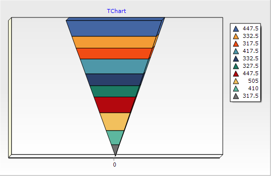

Vertical funnel: If you invert the Left Axis, the TPyramidSeries will look as rotated 180 degrees.

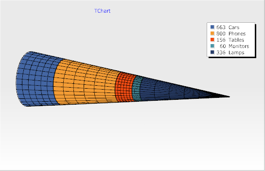

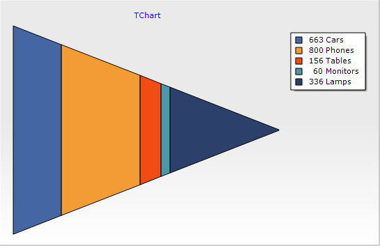

Horizontal funnel: Have you seen the TVolumePipeSeries? If you set it's ConePercent property to 100, it looks weird in 3D but it looks fine in 2D.

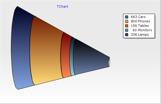

To round it, this doesn't look bad (but Chart3DPercent at 100 gives a strange result):
  Chart1.Chart3DPercent:=97;
  Chart1.Aspect.Orthogonal:=false;
  Chart1.Aspect.Rotation:=324;
  Chart1.Aspect.Elevation:=348;
An alternative would be using OpenGL (here you can put Chart3DPercent at 100 without problems):
