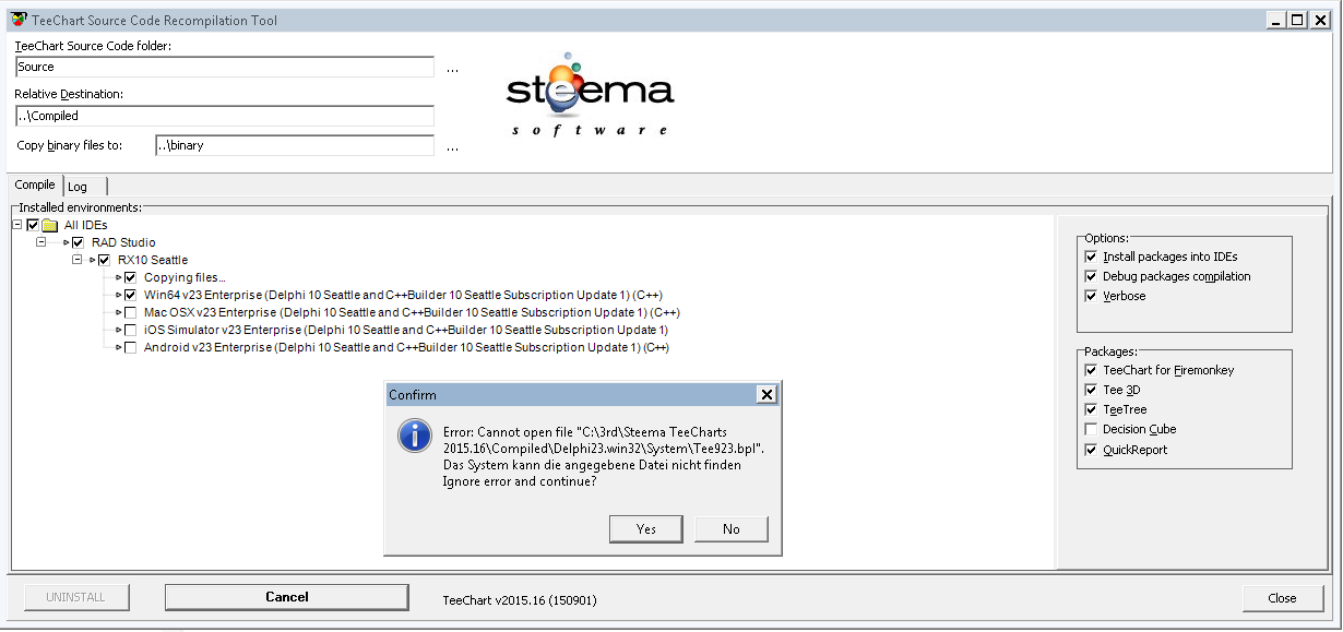

I just setup up a fresh Windows 7 64bit machine with a RAD Studio Seattle 10.1 clean install.
The TeeChartVCLSOURCE-2015.16.exe setup finished without errors, so I went on and ran TeeRecompile to install the TeeChart components into the IDE. TeeRecompile identified the Seattle installation and offered me various targets. I selected only two of them (Win32 v23 and Win64 v23), and TeeCompile presented this error message:
"Error: Cannot open file "c:\3rd\Steeam Teecharts 2015.16\Compiled\Delphi23.win32\System\Tee923.bpl. System cannot find the file specified. Ignore error and continue?"
Can you point me in the right direction?

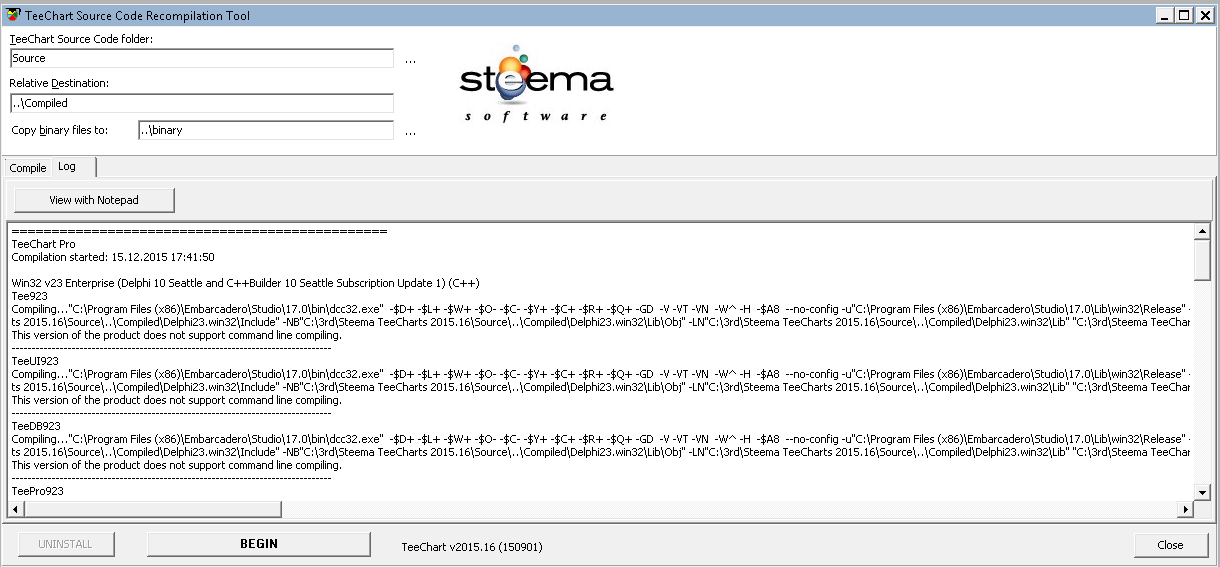

As it turns out it´s RAD Studio Seattle causing the problem. I am using the trial version which prohibts the use of the dcc32 command line compiler.
Invoking the dcc32 compiler yields the error messages shown in the log window.
