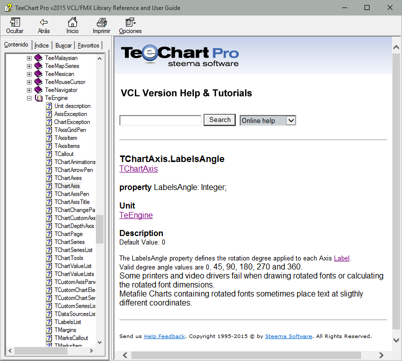

Note the file labelled "TeeChart Pro v2015 VCL/FMX library reference and user guide" looks appropriate but many times when I click on a hyperlink I get the browser message: Error opening Help in Windows-based programs: "Feature not included" or "Help not supported". Rather frustrating - especially when the link looked like it might lead me to the answer to my question. The latest one was a link to "labelsangle" which I wanted to find out how to use in order to have the labels along one of the axes at a slight angle.

fjrohlf wrote:Note the file labelled "TeeChart Pro v2015 VCL/FMX library reference and user guide" looks appropriate but many times when I click on a hyperlink I get the browser message: Error opening Help in Windows-based programs: "Feature not included" or "Help not supported". Rather frustrating - especially when the link looked like it might lead me to the answer to my question. The latest one was a link to "labelsangle" which I wanted to find out how to use in order to have the labels along one of the axes at a slight angle.
I'm sorry, the Win32Help program is to open .hlp help files.
There may be some link broken in the TeeChart.chm help but I can open it with Windows 10, and I can search for LabelsAngle without problems:
