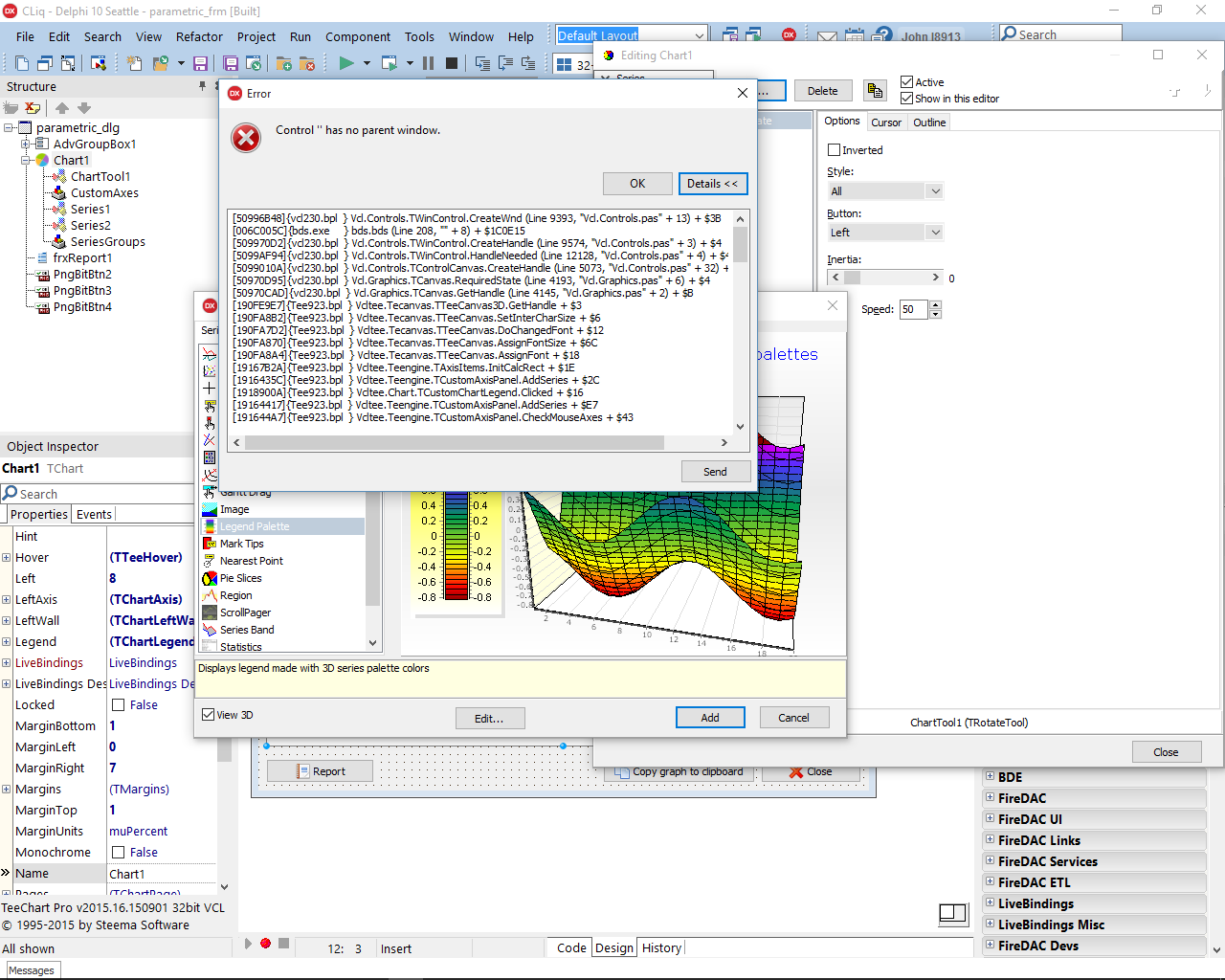

I just upgraded to Delphi XE10 and installed the latest TChart but it looks like I still get the same error when adding a legend (the error occurs when I hover the mouse over it). Is there any way to trace and fix this error?
Screenshot 2015-11-08 13.48.49.png (166.93 KiB) Viewed 20161 times

Ok, here is a sample project but I am sure you will not be able to reproduce it there so I also included the executable with EurekalLog enabled.

I see no error hovering the mouse over the legend with your .exe and neither recompiling the project.

.... so where could be the issue? I cannot rely on the fact that this error happens on my PC only :(

We've tried running your exe in a couple of machines here with the same results. We can move the mouse around and no error is shown.
If you think we can be doing something incorrectly, maybe you could post some screen-cast so we can be sure to be doing the same here.
We also tried to rebuild the project, add points to the series, connect the legend palette to the series,... and it always seems to work as expected for us here.

Any hints on how I can trace down the issue?

johnnix wrote:Any hints on how I can trace down the issue?
Do you have access to a second machine to try the exe?
If you can reproduce the problem with that exe in different machines, maybe you could record a screen-cast and send it to us so we can be sure to be doing the same.
