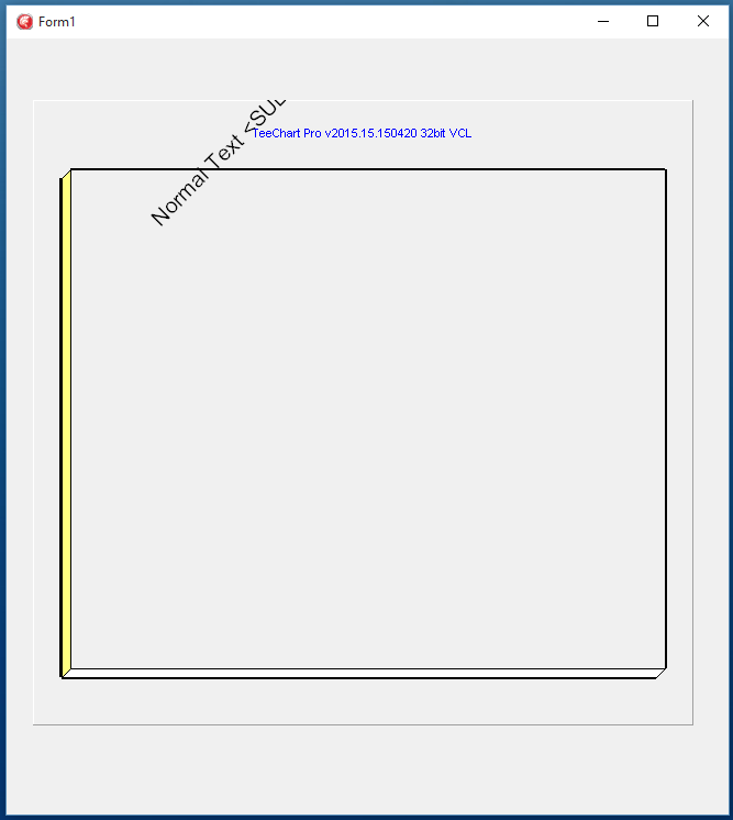

... does not work for me
What could be the issue?

Re: Question about RotateLabel
What IDE are you using?
Delphi XE7 Version 21.0.17707.5020
Looking again at your screenshot I've seen what is making the difference here: RotateLabel method doesn't support HTML5 tags in GDI Canvas.
http://bugs.teechart.net/show_bug.cgi?id=1343
In the meanwhile you can use GDIPlus instead of GDI.
