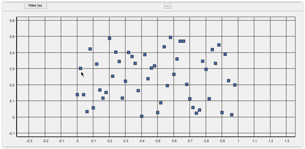

I've extracted the "Isometric Axis" demo from the Features Demo and modified it to use a TPointSeries with values in the ranges you mentioned.
But I'm not sure to understand what would you like to achieve here.
This is how it looks: And here it is the project:

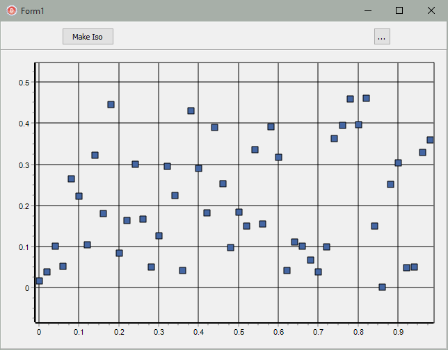

I have attached an example. Note all the uninformative regions to the left of 0.0 and right of 1.0. What I want is for the window to be constrained so that those areas need not be plotted. In the present example it means that the plotting canvas needs to be constrained so it is twice as wide as high no matter how large or small the user makes the window.

I've modified the project above including a button that modifies the ChartRect to the minimum needed to display all the points.
Take a look at it:
Take a look at it:

Getting closer. I will see if I can modify this new version to do what I want. Make iso would be ok if it shrunk the size of the teechart component to be just a little larger than what is actually used to display the plot.
