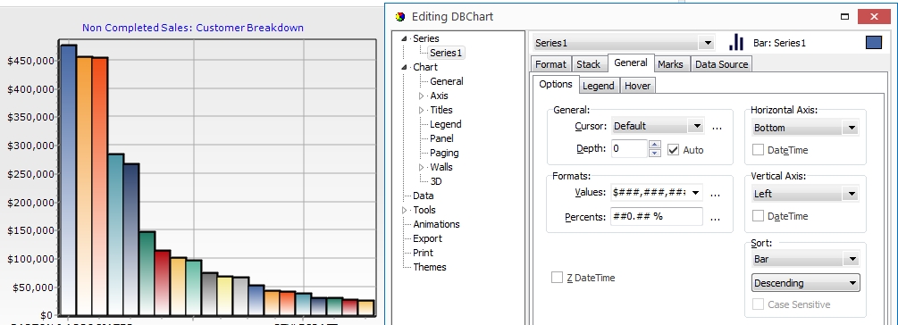

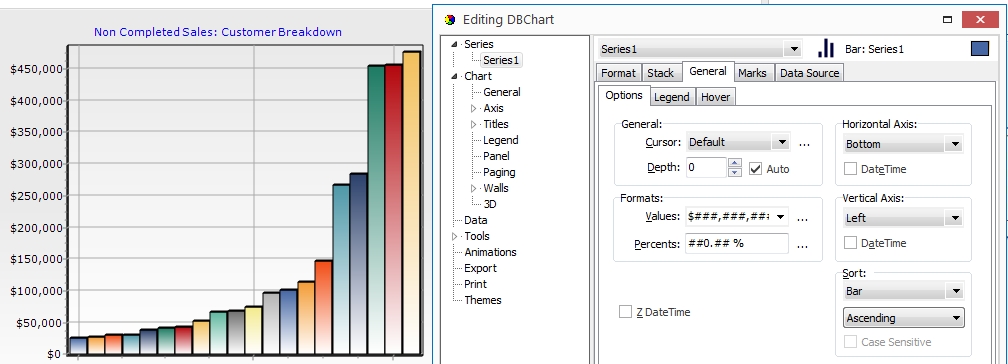

Here is what I'd like to be able to do - these 2 images:
Programatically be able to set what appears to be Series1.General.Options.Sort to "Bar Ascending" or to "Bar Descending".
How do I do that?
