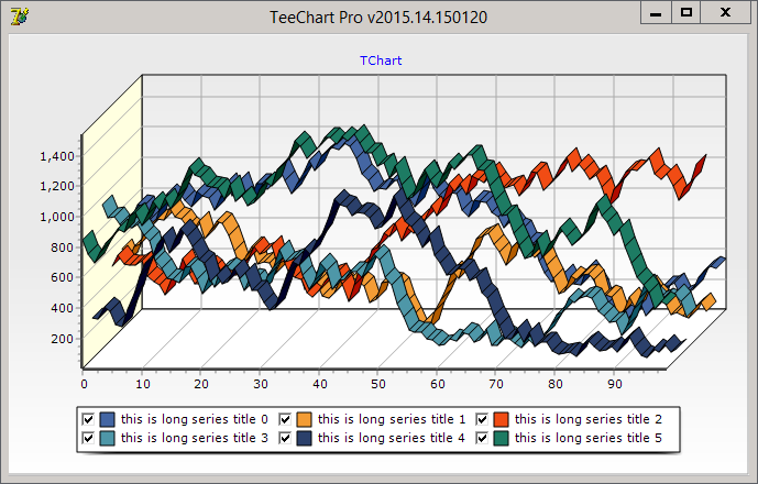

Re: Wrond legend display with 2015.14 update
Post by Yeray » Mon Feb 02, 2015 3:47 pm
Hi Uli,
I've tried this with both v2015.14 and with the current internal sources we have here and it seems to work fine in both:
Here it is the project I used:
testBottomLegendCheckboxes.zip
(1.67 KiB) Downloaded 1392 times
Am I missing anything?

I have downloaded your test project testBottomLegendCheckboxes.zip
Indeed it works with 3D display. BUT please switch 3D off and you get
Regards
