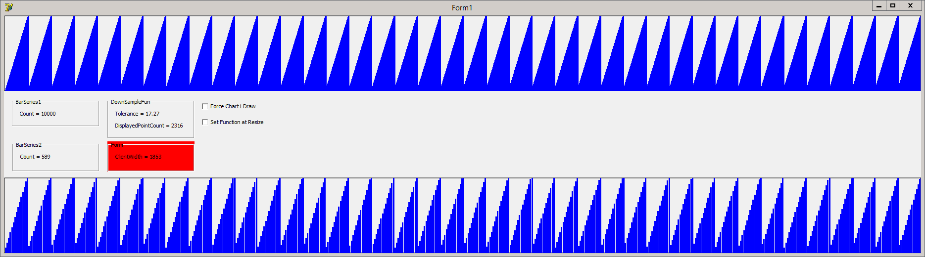

I have a problem using TDownSamplingFunction. The attachment is an application to demonstrate it.
What I basically want to do is display a chart with 10.000 points. When my form is only 1.000 pixels wide the chart can easily be reduced, speeding up the display of the chart:
  DownSampleFun.Tolerance := BarSeries1.Count / ClientWidth;
  DownSampleFun.DisplayedPointCount := ClientWidth * 4;
This works 90% of the time, but there are situations where the downsampled chart has less points than visible pixels (on the x-axis), which looks like this:
instead of:
If you resize the form from narrow to wide, the effect can be seen. In my real application the problem is even more visible.
How would I have to modify the application so the vertical 'white' lines will never be visible?

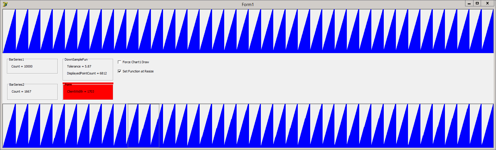

I could see the problem now consistently resizing the application I sent you to more than 1800 pixels width:
I've seen it can be fixed if you recalculate and reset the function Tolerance and DisplayedPointCount properties according to the current width (activating the new checkbox in the revision of the test application):
Now, I can see the box is still red for some widths, but the series always seems to look good:
